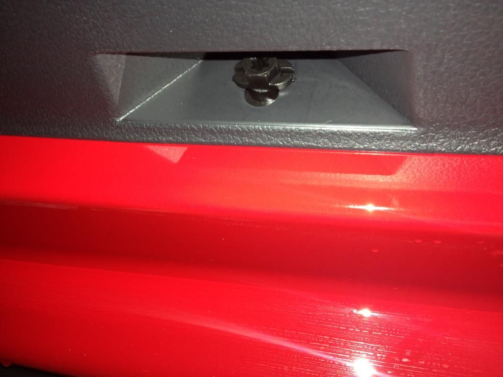

Use a ring spanner to turn the plastic clip at the bottom of the door card 90 degrees:

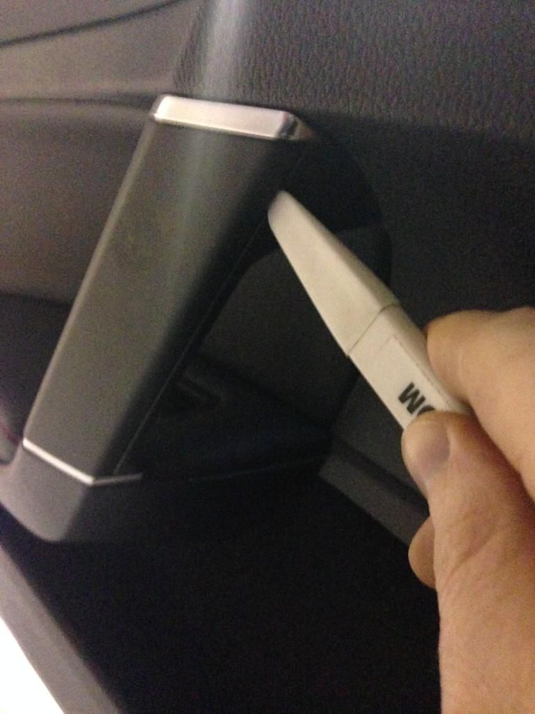

Pop off the cover to the grab handle:

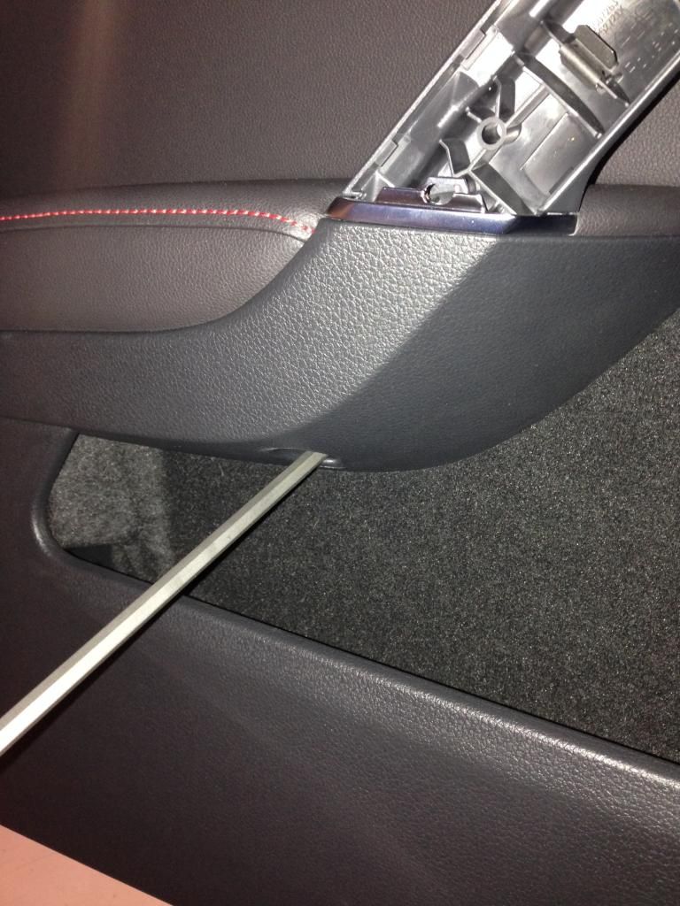

Remove the one bolt behind the cover an dthe other below the grab handle:
The next bit requires brute strength and care. Pop all of the clips holding the door card on. You are pretty much guaranteed to break some so do get spares.

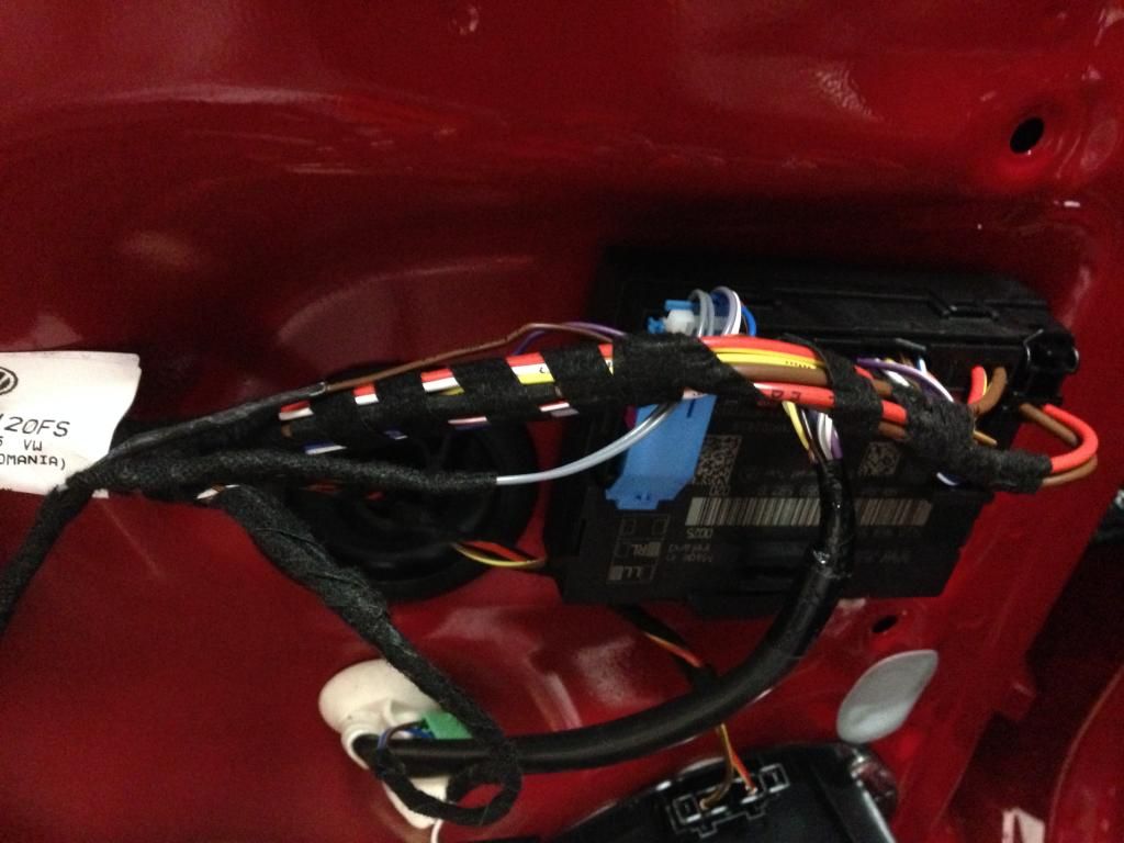

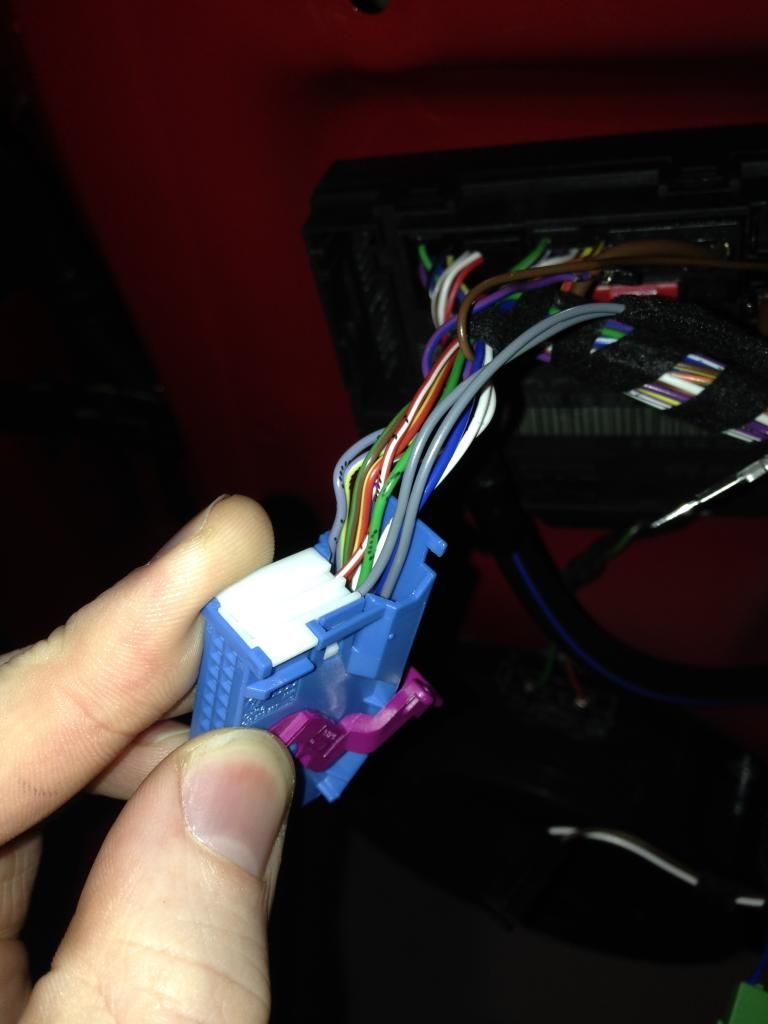

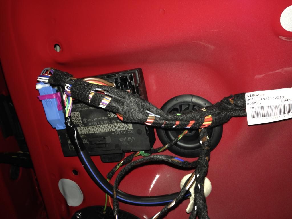

This is the right side door controller with blue 32 pin plug:

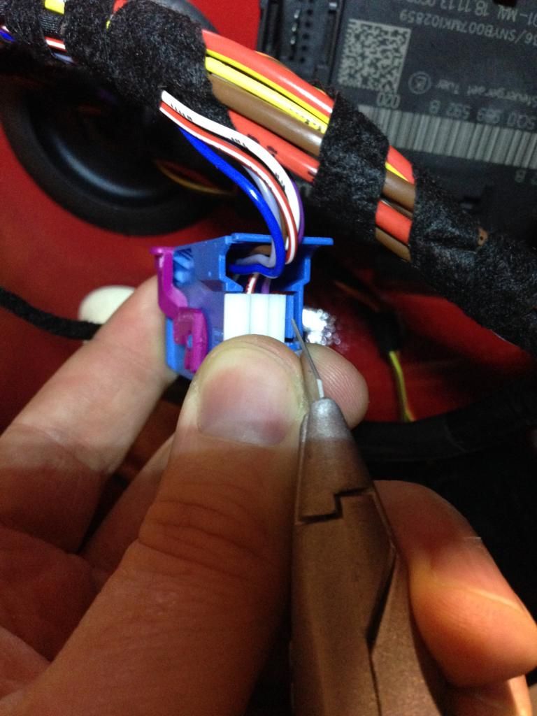

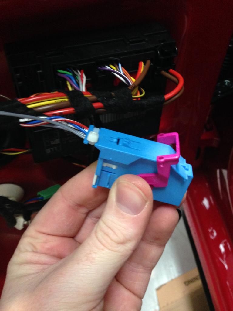

Remove the plug, cut the cable tie holding the cables to it and release the white plastic piece from the blue cover.

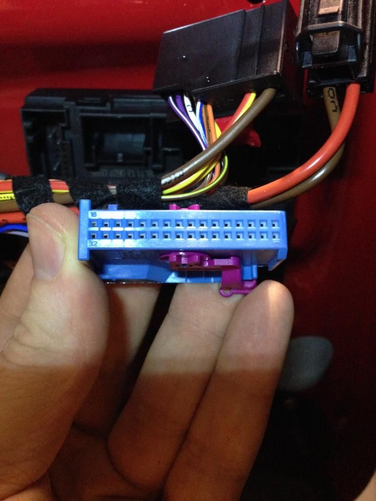

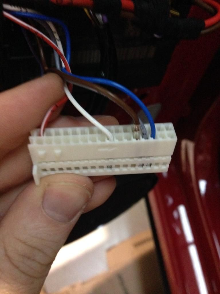

The 2 wires we are interested in are the brown at pin 5 and the purple at pin 16:

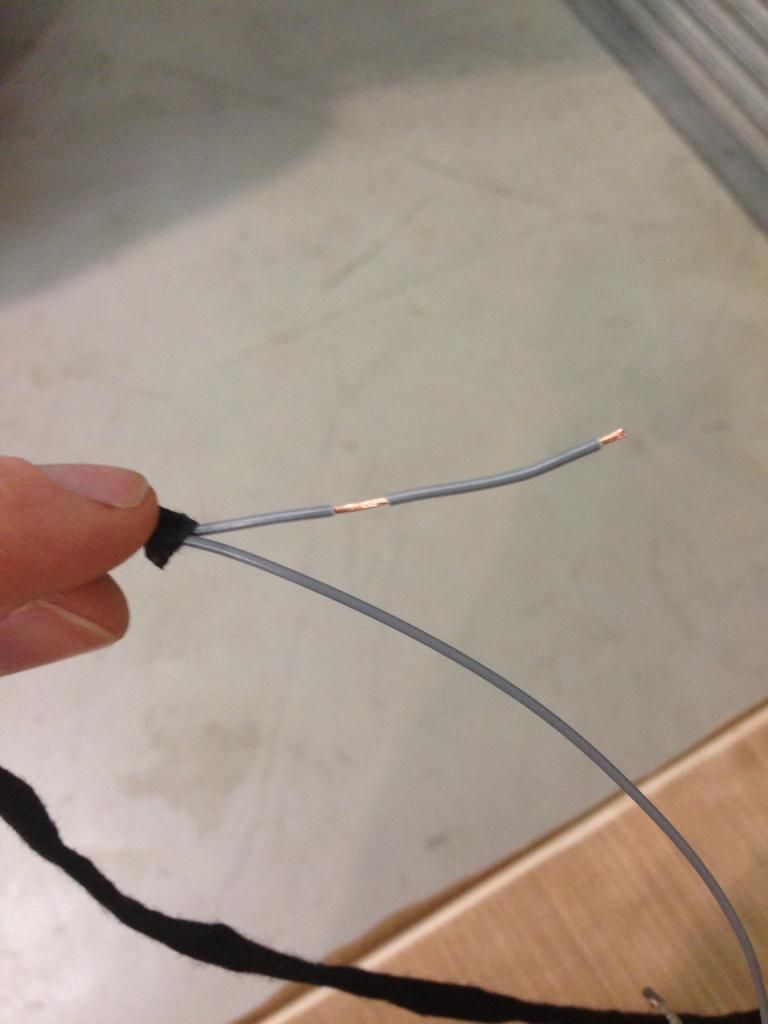

Remove these pins from the plug and lie them back along the loom towards the rear of the door and plug in the ends of the new loom in their place:

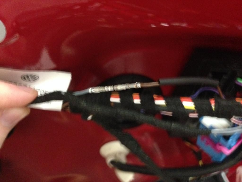

Next join the purple and brown wires from the car loom to the spurs in the new loom. These pins will plug securely and easily hold themselves together. Put some heat shrink tubing around them to hold them together and insulate.
Now tape the loom to the existing car loom, put the 32 pin plug back together and fit a new cable tie.

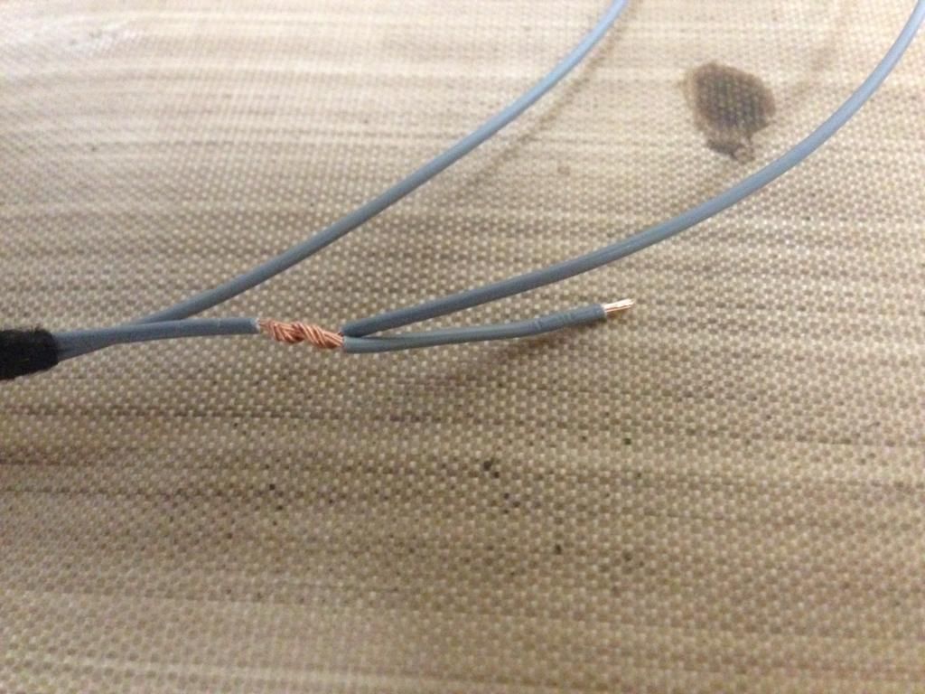

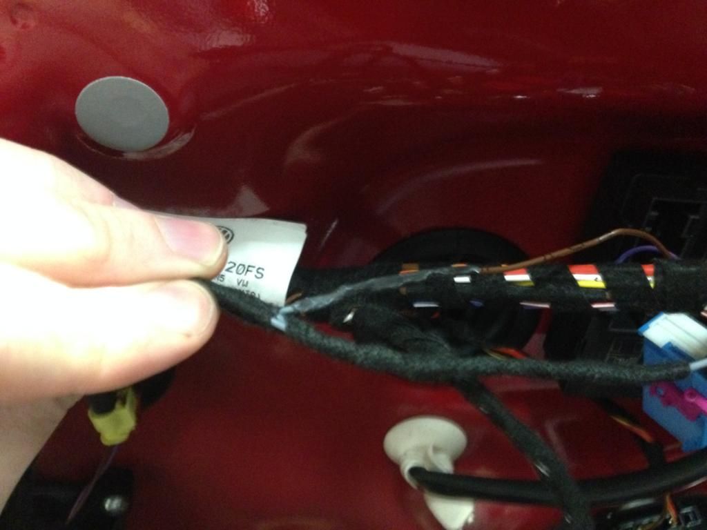

Here is a picture showing the left side with the plug back in but the wiring not yet taped up and secured. You can see the 2 new grey wires coming from the 32 pin plug. These are the terminals to the far right in my diagram. You can also see the purple and brown wires that used to be plugged into the 32 pin plug. The shrink tubing on the brown wire covers where it plugs into the spur on the new loom. The purple wire wire is also joined in the same way but it's obscured by the thick bundle of cables.
The pic below is of the right side with the plug back in but the brown and purple wires not yet joined to the new loom. If you are wondering where the other spur is, you can just see it to the left of the thick brown and red cables going into the door controller.

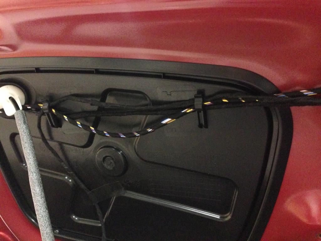

Tape up the loom and run it beside the existing loom through the 2 hooks. Then turn it down toward the bottom of the door. In the pic below, you can see that I taped it to the door to secure it.
