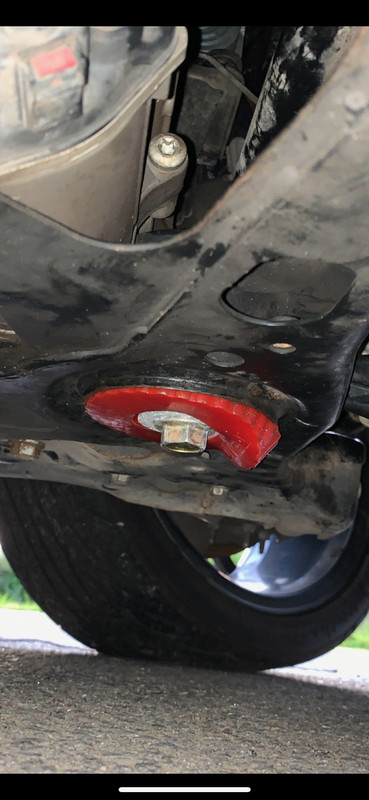

Hi guys , I have recently had installed the revo lower engine torque mount , have done around 50 miles since having it , noticed some strange noises while driving , have looked underneath and see the front part has come out from the hole in the subframe where it sits  , I do have a photo but can’t see how to upload on here , has any one had this happen before ? Thanks

To post an image you need to use a hosting site, lots available but postimg.cc.org.uk is popular (I use it). Upload your image choosing not to adjust the size then copy the hotlink for forums code and post that into your post. Good luck with your issue!

Hi there , revo had a problem with the mounts from power flex I have a new one in now but still not very happy with it , I’m gonna go back to standard bush and insert
