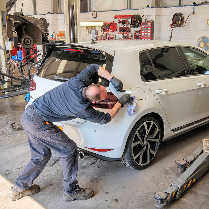

« Reply #18 on: 01 June 2021, 19:52 »
So finally today while in for an oil and filter at my local VW specialist the technician managed to get my fuel flap open. Actuator failed completely and a new one ordered. It was a major fight for him to get it open, no way I would have done it at the petrol station.
Remember folks, make sure you keep your flaps clean and lubricated!  :wink:
