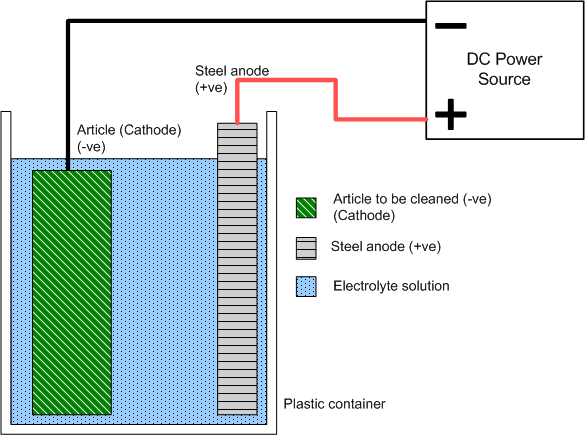

Illustration of the process:
Source: http://www.smex.net.au/reference/RustRemoval04.php

So I got all the things mentioned above, what next?
- Fill your plastic bucket with water. A detail you want to clean has to be fully under the water
- Add Na2CO3 or NaHCO3 (1 gup is enough)
- Put your anode in the solution (anode will catch the rust from your part). Make sure it's a bit larger than your detail.
- Put your part in the solution (cathode)
- Fasten the positive (-) cable to the part you want to clean
- Fasten the + cable to the anode
MAKE SURE anode and cathode won't touch each other
Don't fasten + and - the opposite way because then your part will catch all the rust from the anode rust.
Make sure you have a connection between the anode and cathode. You can test it with a light bulb.
After you have set your environment you will soon see some action in the bucket: tiny bubbles and fizzling noise. The water will take a rust color.
