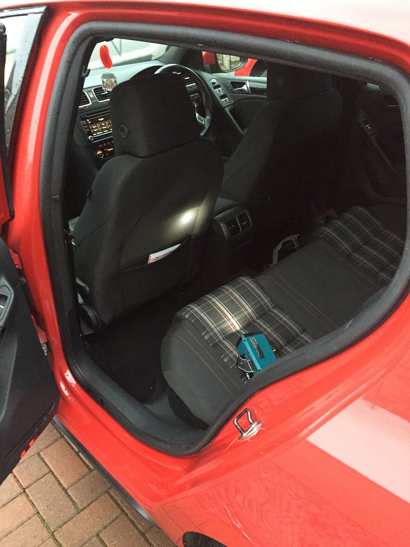

Hi after spending most of the day drying out the floor carpet and spare wheel well I need to fix the water leak. What door seal do you replace ? The one on the actual door or the body one ?
The body seal is allowing water to come in at the bottom, not sure if this is due to the seal on the door being worn ?  Would the water also work its way to the spare wheel area ?

if its the same as mk4 take the door panel off there should be a metal plate bolted to the door its that seal that lets water in  :smiley:
