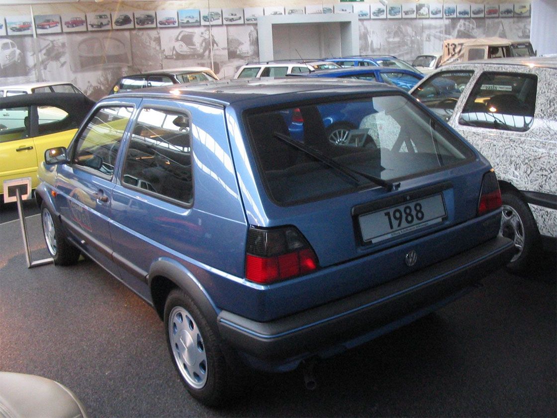

Thanks for the responses, this car is an '88 so I guess that means it has the older version of the GTI seats, these also came with the padded dash opposed to the Plastic dash base models had, they also came with BLUE striped bumpers. and smoked/red Hella taillights aswell as power windows and teardrop/silverstone wheels. One sits in VWs museum, picture attached.
It is impossible to find replacement fabric/seat covers for these so I am lucky that my seats are in good condition with No torn fabric. its only a bad dvrs seat bolster that lets it down so really all I need is the complete lower foam section, it also seems that there is foam falling from the seat onto the carpet so it is disintegrating
If anyone has this section and wants to sell it, please PM me. I am willing to pay up to 100 quid for just this bit if its solid. Really hope i can find this part as ebay comes up with nothing.
