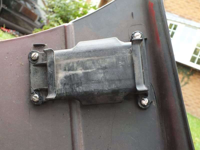

So, to be a bit more specific...
This is the bracket what turns up everytime I search the internet, the one I DONT want!

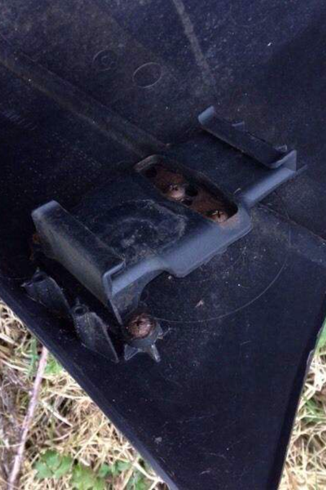

This is what I DO want...

You can call me names if you like, but those brackets look like they will do the same job...

Buy the brackets You can find and just mod to fit. Two of the screws are in the right place, just cut a hole in the other ones and pack the gap.

if you drill 2 new holes and countersink them it should work fine.

I had this problem, so I cut the mounting points off them both and plastic welded the genuine part onto the repro so the mountings lined up. Then small self tappers to fix to bumper :)
