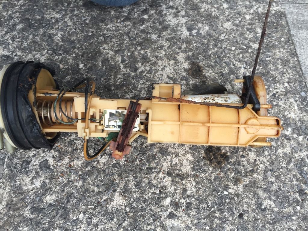

maybe a second hand sender with a new pump fitted would be the answer. any chance of putting a pic of the old assembly up?

« Reply #4 on: 04 May 2015, 18:12 »
Offline dai-cymru
  • Posts: 2,601
  • 1989 MK2 16V
Re: Golf KR lift pump
« Reply #5 on: 04 May 2015, 18:13 »
Offline gazareth
  • Posts: 1,346
« Reply #6 on: 05 May 2015, 22:55 »
yeah it looks a bit rough alright. the one of a post 90 spec 8v or 16v should work fine. but you could probably clean the old one up. as long as the pipe from the pump to the fuel hose outside the tank isn't rotted through or the resistor strip for sender damaged. you could make a new wire for the float out of a coat hanger.
