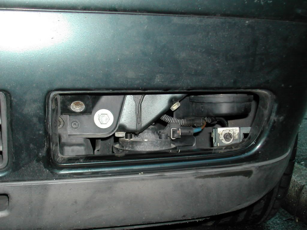

You tried the one behind the bumper?
Offline hardmonkeys
  • Forum Supporter
  • Posts: 951
Re: Displays reading wrong tempture
« Reply #2 on: 30 March 2015, 10:27 »
There's a sensor on N/S behind the front bumper, might of come out its housing.
Looks like this
