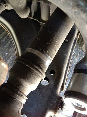

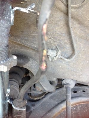

I've been having some knocking and the ABS, EPS lights have been on since I had my coilovers fitted so had a quick look and this.
Do you think this could be the cause of the knocking and the lights also is the damage to the drive shaft caused by the ARB?

If that brake hose is damaged I would not use it until it is replaced asap.

the drop link is f*cked, your arb is rubbing on the drive shaft and the abs sensor harness wasn't clipped back in to the strut and has rubbed through on the wheel. R32 roll bar or similar, new drop links and a repair harness from vw (about £40) and you should be right.
