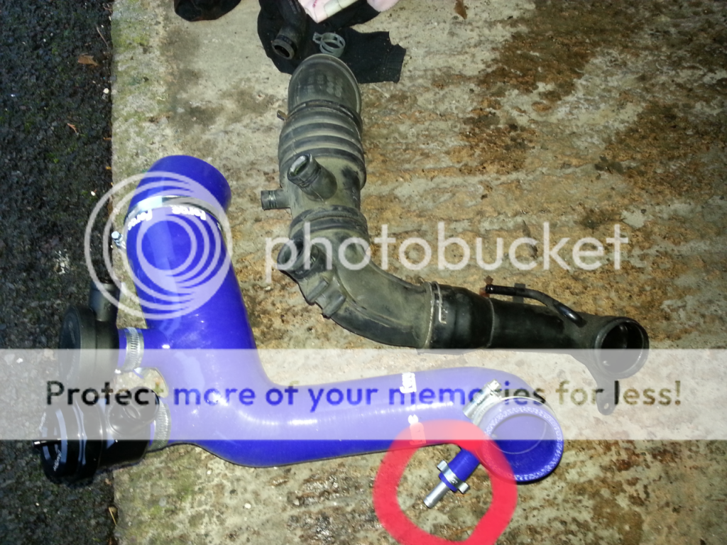

I picked one up from a guy on fb. Anyway i just had a good look at it and this has 4 ports on the air filter side, 1 for the dv, 1 for the hockey puck thing & 1 for a vac line & another one for?
Mine is the agu so i know i can block the other port off with a bolt or a cap if i can find one.
now main problem is that on my forge the tip has a metal bit on it by the turbo side this is were a tube went to. Now this r-tech tip dont have the metal bit for the pioe to connect. Were could i get one from?

Thats 4 ports/holes. This has 5 its from a octavia that had a k03s. Defo an extra port. I know theres a vac pine right by the turbo for the tip but there is 4 ports at the top. I will defo need to check with my forge one. Also were can i get a metal joiner/connector thingy for the tip? This is right at the bottom were the tip joins onto the turbo a vac line goes to it. Il try and tet a pic up of it.

anyway this is the bit circled in red

The thing people put the little filter on is the intake for the secondary air injection, the circled item is part of the emissions recirculation crap from charcoal canister.

i know a pipe goes onto that but i need the metal bit as the rtech one dont have the metal bit for the pipe to connect to it. Its like an adaptor for it.

Might be able to pick up 3mm ID alloy tubing from eBay for not much, some sellers do swaged ends too
