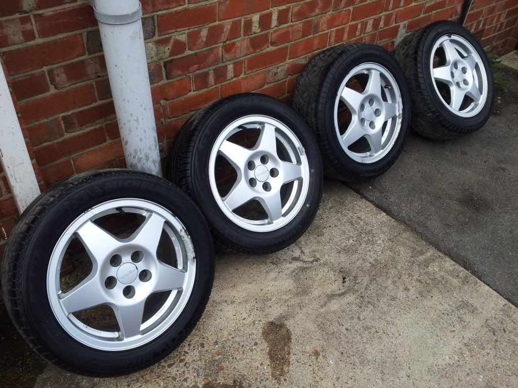

Finally, a couple of tyres were near the limit, and the other two had cracking on the edge of the tread. I'm after a nice set of RX2s, or RCs in a few months time, so just needed something for the interim. These then came up for a price I simply couldn't refuse, all with tyres 6mm up.
Wheels were a bit grubby to begin with, but soon sorted them out!
Marks left over are corrosion, but not too fussed as they'll be flogged on once I get the solitudes refirbed, booted out, and have me a set of decent summers.

First of was a set of decent rims.
Trying to go with the OE+ theme, and the single piece RXs look like they could have come from the factory imo. That and the fact they're much cheaper that the splits!
