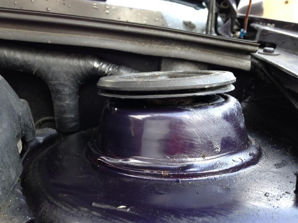

not sure what to do as im fed up of changing them every year , the bearings never go its just the rubbers squash and cause a gap in the top hats in the bay and squeak , may take them off grease them and see what happens

« Reply #13 on: 12 January 2014, 22:33 »
Post a pic of the gap.

they look normal to me

« Reply #16 on: 13 January 2014, 18:45 »
Look fine to me too.
I replaced mine when they where twice that gap.

« Reply #17 on: 13 January 2014, 21:59 »
Look ok they do!

That's good news then !
So looms like I should take them out and grease them by the sounds of it as they only squeak when cold ?
