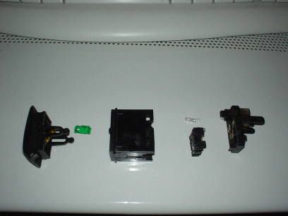

and .........
1 dismantled switch, should all be obvious how it all goes together:
mail@trimdeluxe.co.uk
