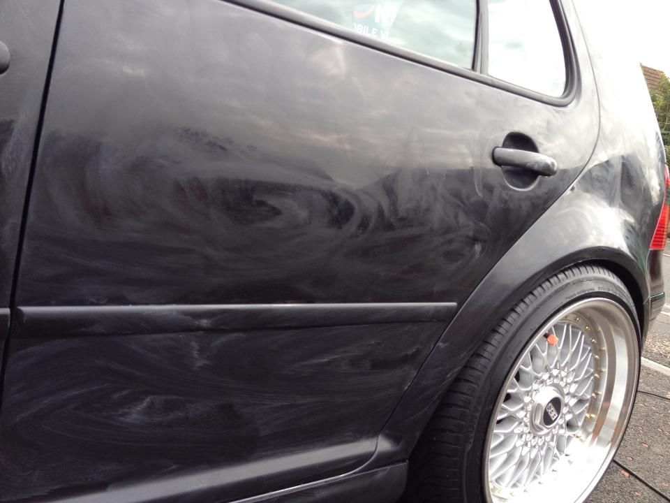

Well the detailers were round in full force today  :cool: very pleased with the outcome. the break down was
 Apply traffic film remover to lower body work including wheels.
 Then rinsed off.
 Pre treated with snow foam allowing 15 minutes to dwell.
 Then rinsed off.
 Hand wash body work with carnauba wax and shampoo using the safe 3 bucket method,(wash, rinse, wheels)
 Petrol cap cleaned.
 Then rinsed off.
 Dried using leather and a non scratch microfiber towel.
 Tyre shine.
 Tar spots removed.
 Paintwork corrected using a safe dual action machine polisher to remove all imperfections.
 Paintwork sealed and protected for 12 months using Diamondbrite stage 1 & 2 .
 Exterior windows polished.
Got a few pictures  :smiley:
