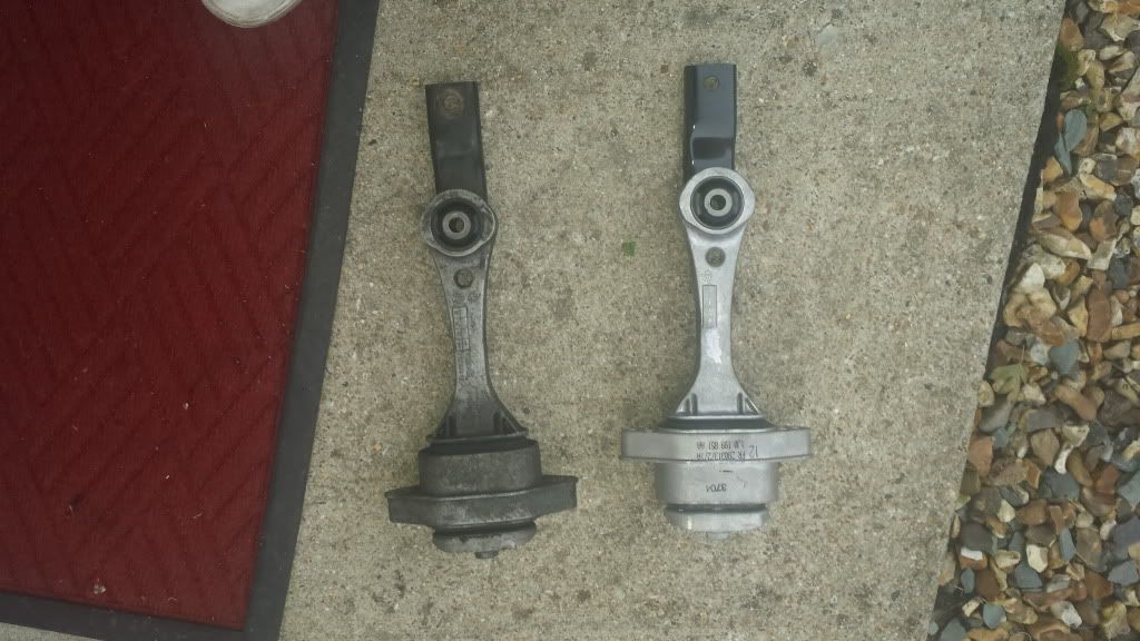

Soo any of you that have read my downpipe rattles thread know that I needed a new dogbone mount. Well it arrived today and was replaced within half hour one of the easiest jobs to do on a mk4 by far well you would think ....... over a year ago I installed poly bushes didnt like them put the standards back in cant say ive noticed any difference but anyone notice the error when I re assembled the old one ??? 50 unofficial scott mills point on offer to the winner !

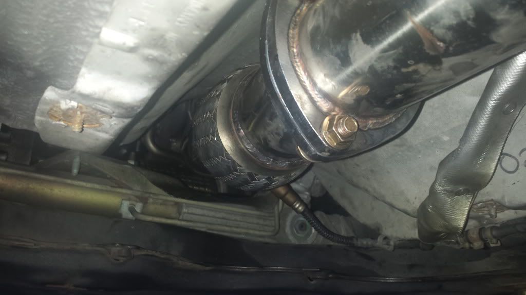

so with that resovled ive now got a good 2 inch clearance !!
Before
After

Haha it's round the wrong way! Surprised it went back on okay..

My guess is the one on the left was assembled this way all along. I had the exact same clearance issues with my downpipe when I put mine back together the wrong way round.

Easy mistake to put it wrong way..but still  :grin:
