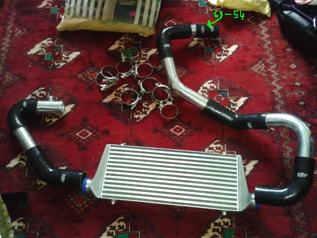

<a href="http://s878.photobucket.com/user/Darrenscriven/media/2013-08-05151544.jpg.html" target="_blank"><img src="http://i878.photobucket.com/albums/ab347/Darrenscriven/2013-08-05151544.jpg" border="0" alt="Intercooler &amp;pipes photo 2013-08-05151544.jpg"/></a>
Does this pipework set up look right, or am I short a pipe or two?
I do have the 8mm and 25mm pipes for the 45 degree alloy, just haven't got them welded yet.
Cheers

You'll need another silicone 90 and a straight connector (goes between the silicone 45 and the metal 90 on the cold side)
Other then that looks spot on  :wink:
Thanks rio  :smiley: will a 100mm length connector be long enough?

Yeah mate, the 2 silicone ones will be touching  :kiss:

cool, thanks! Looks like I am going to have to move my catch can to make room  :smiley:
