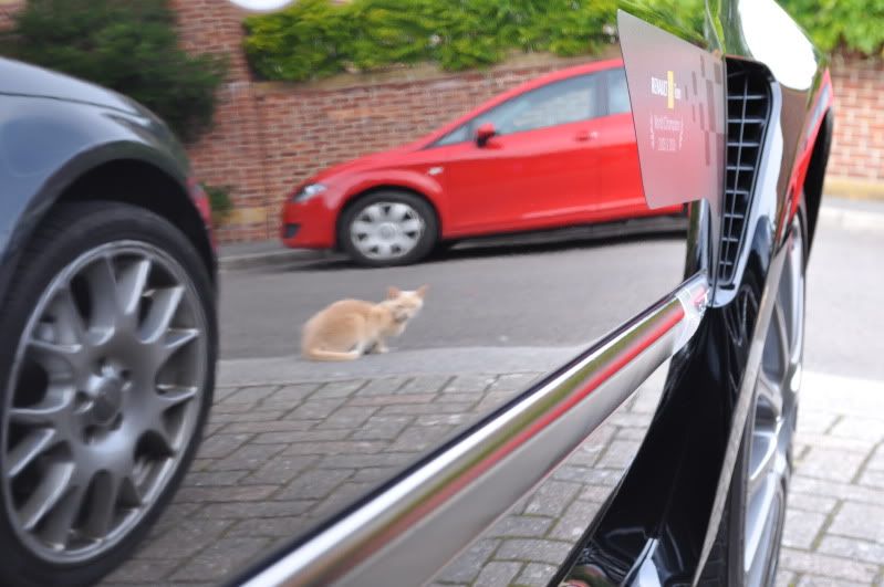

Colonite is a great synthetic wax so will give a deep reflection, carnuba and natural wax will give a deeper shine but less defined and deep reflection... FYI  :smiley: my general rule is darker the colour go synthetic
Synthetic
Carnuba
