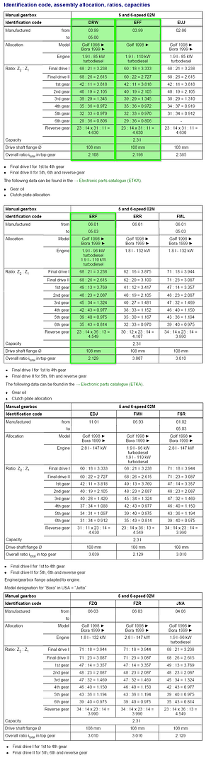

Hi all, can anybody tell me if the gearbox on a V5 is the same as on a 1.8T?? Im thinking it should be unless ratios are different??

Ignore the green highlighting as they are six speed boxes in diesels but the ratio's are there for other codes so you can tell the difference if you know both boxe codes

V5 will be a different bellhousing shape so will not fit a 1.8t.
