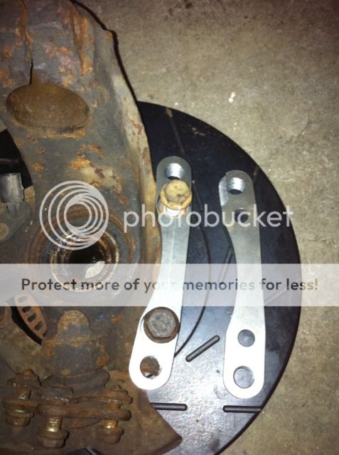

Need to get brackets, R32 discs and Porsche to Vag brake lines. All can be bought over the net. Pop onto R32 owners club and do a search there's a good few threads on there about them.
Here a picture of the brackets, I got a friend to make these but you can get them from eBay or there's a lad on R32 owners club that make them.

Not feeling the idea of all that extra braking force transfered through those carrier adapter brackets.  :undecided:

« Reply #4 on: 07 March 2013, 08:50 »
Personally they look dangerous.

« Reply #5 on: 07 March 2013, 22:18 »
Me too, they look like they are made from Meccano  :grin:

« Reply #6 on: 08 March 2013, 11:13 »
Come off it... I know it is a 'soft' metal but I feel that would cope fine.
Metals have come a long way since Meccano!  :grin:

« Reply #7 on: 08 March 2013, 13:39 »
would you risk it though??????
when it comes to brakes you want to make sure every component is of good quality

« Reply #8 on: 08 March 2013, 14:53 »
I appreciate the importance of brakes, but I don't think that aluminium bracket would fail. I'd be worried about the tyres and or road surface more.

« Reply #9 on: 08 March 2013, 16:14 »
It shouldn't do but as far as metals go its not greatest for the application. Its light but weak compared to steel. Id be wary with them after a little while
