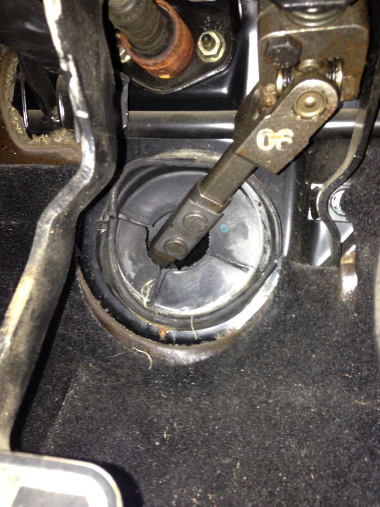

Door seals
can't be that cos the wet was originating from the centre console side.
could this be it? is this supposed to look like this?

« Reply #13 on: 02 March 2013, 21:04 »
mine has a full boot on there... (looks sort of like a cv boot)
that could cause water ingress

Re: damp drivers footwell help!
« Reply #14 on: 02 March 2013, 21:33 »
ah ok what do I search for to buy one?
