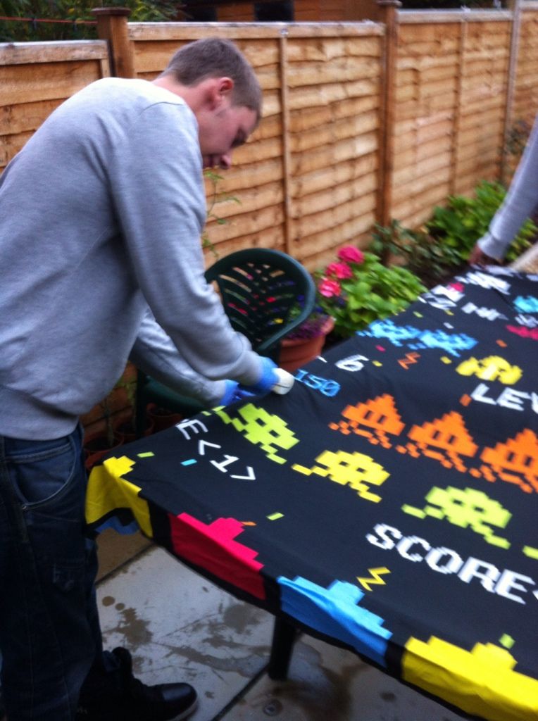

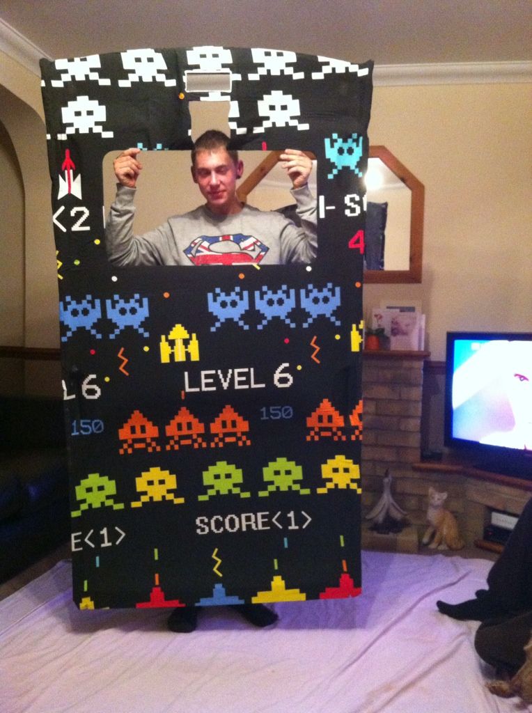

all done today wasnt as easy as i wanted it to be but got done in the end , i can see a few staples going in the roof when the glue starts sagging  :undecided:
