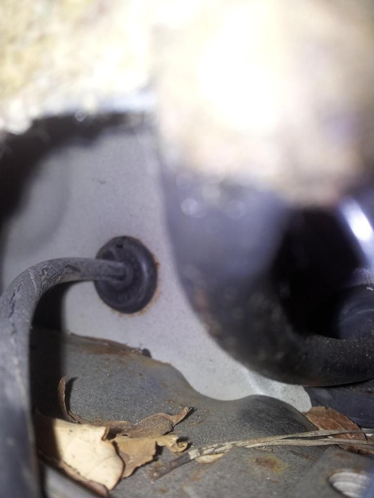

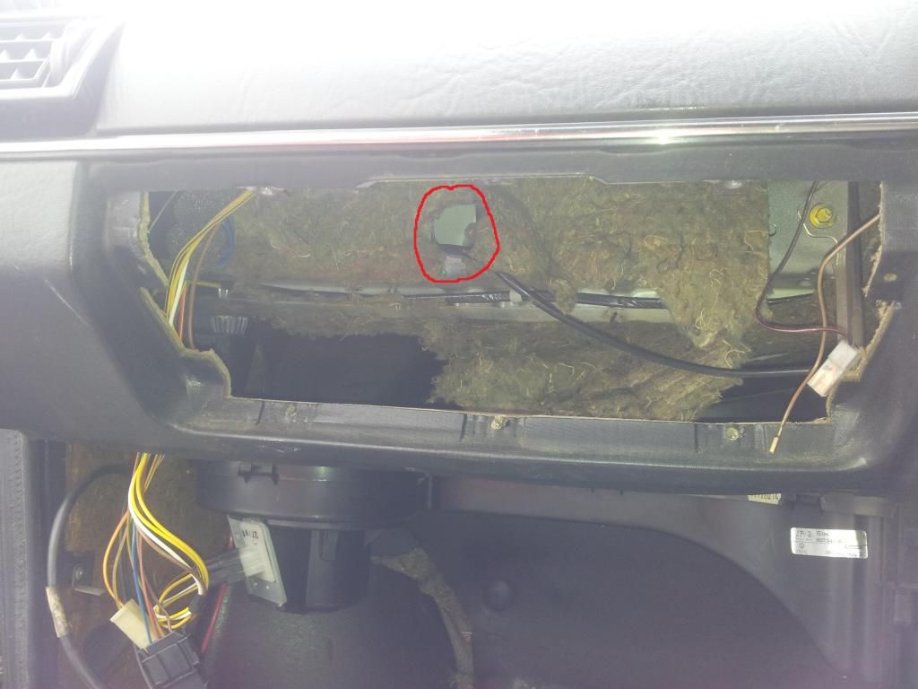

hey guys searched high and lowfor a hole on my bulk head and iv concluded that its getting into the box section for the dashboaard
 i do have a rust hole on the drivers door pillar but i ran some water down the gutter and it wasnt leaking in there and when it does rain its filling the footwells up alot so there has to be a large leak somewhere, i mean theres f**king leaves and sh!t in my bulkhead how the f**k did tat get in there. iv found a hole next to the ecu right before the drain sealed that up ... still leaks sealed the heater fan up .... still leakes i have some small rust spots around the windscreen and 3rd wiper hole sealed them tempory and guess what .... still leakes getting abit impatient now cos i want to put the carpets back in and the drain plugs in the floorpan but at the minute its leaking like a f**king colinder lol (as you can tell i love colourful vocabularies)
any clues guys iv exhausted all my efforts so will try anyting anybody throws my way
