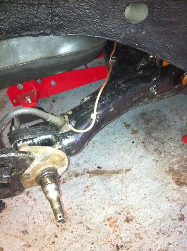

Righto decided not to swap in to a 3 door but have taken off the road to make it into a minter.
Ive removed the rear axle, hubs brakes etc. sanded them down and repainted, just waiting for poly bushes for rear axle, brake pads and discs and new wheel bearings. I'm replacing the metal and flexi brake lines aswell. also did some arch work to make 9js fit with out rubbing! Cut out arches and welded the inner skins together.
Pics to follow
Right made some good progress tonight!
Wire brushed, sanded and Primed then gave the rear axle 3 coats of satten hamerite spray paint, looks good.
Ordered new poly bushes, genuine rear disc back Plates, rear pads, discs and wheel bearings.
Removed fuel tank, lines and pump and filter system.
Just need to remove a couple more things and then it's ready for a full jet wash and clean up underneath.
Once thats all completed it will be getting a full inspection for the dreaded rot, any found will be cut out and new plates welded and smothed in.
It will be then fully wax oiled and then re stone chipped / shultzed underneath!
Pics to follow

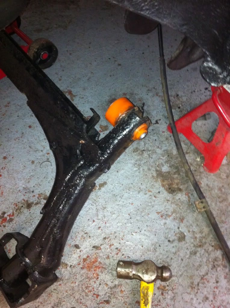

Right not been on for a while but here we go!!
I cut back all the dreaded rot wax oiled behind it and then welded her back up, seam sealed all the welds and then stone chipped her. I'd stripped all the petrol tank axles etc off before I stone chipped to make sure no bits were missed, I want her to last a while :)
I then cleaned the 20 years of crud off the petrol tank, poly bushed the rear axle and made and fitted all new brake lines . And fitted it all back up.
, I have all new rear flexi brake lines coming, disc pads and wheel bearings and some brand new genuine rear disc back plates :)
Will update more pics soon
