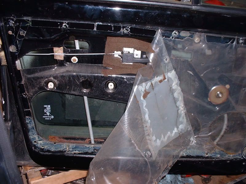

Do mean the rubber highlighted below?
If so then don't fret about water passing through it, this rubber is not designed to prevent water going in the door, this applies to practically any car.

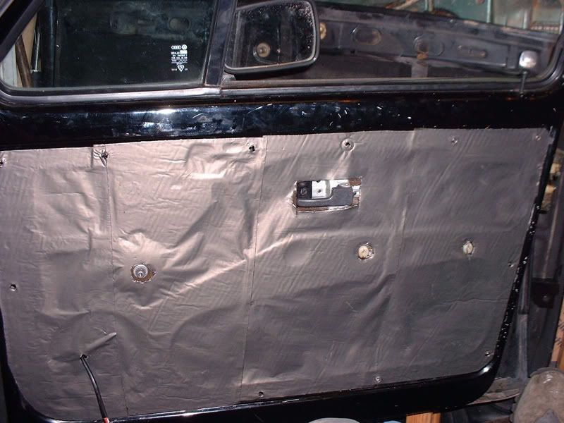

If water is getting in the car from the doors then you need to check the drain holes at the bottom of them as these being blocked is common. With the doors open you'll notice a couple of rectangular holes facing the ground. theses must be clear.
Also, with the door card removed, check the plastic membrane behind it, this must be in good order and sealed around the edges.
If it isn't, replace it.
Keep an eye on ebay or your local scrappy, the rubbers do turn up, more so for cabbys than tin tops.  also try Crazyquiffs.
