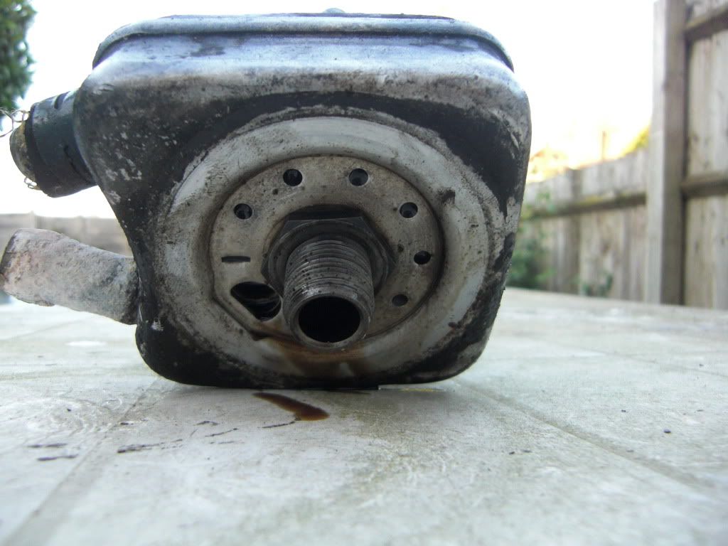

does anybody know how to take the assembly off the block? Cheers. :smiley:

The 3 outer holes are bolt holes. You need to remove the cooler itself to get to the bolts holding the rest to the block.

Cheers Khare. Still abit confused tho. I agree about the bolts, mine are allen ones. The access is blocked by the cooler, so how do I get around that? (I have a feelin ive missed something here?!)  :undecided:

To remove the cooler you need to remove the oil filter, then there's a big nut, can't remember the size but I think it may be 24mm, could be 32mm though. Remove that then the cooler just slides down the threaded bit where the filter is.

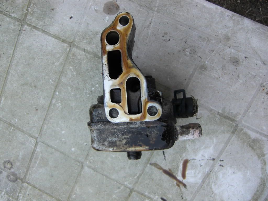

Khare have you got a picture of the pipe with the bit of hose and clip still attached. Would like to see the top edge of that pipe without the hose to see if it has a groove in it.

Yes they are ribbed at the end. Its just hidden on that pic by one bit of hose, and one thats covered in coolant residue and crud!

I know they have a rib at the end.... Further along a dipped groove in the pipe on the top edge !!
