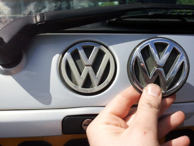

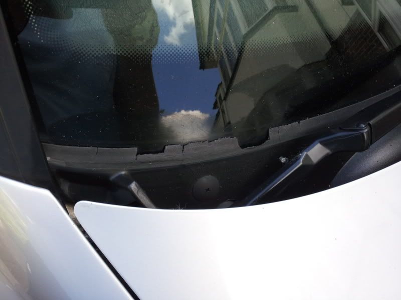

So first day with the car began going straight to the breakers yard with a decent shopping list. The breakers was great had loads of mk3's so lots of choice for good parts. I managed to get;

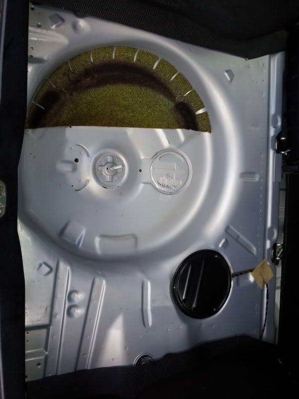

mint rear badge

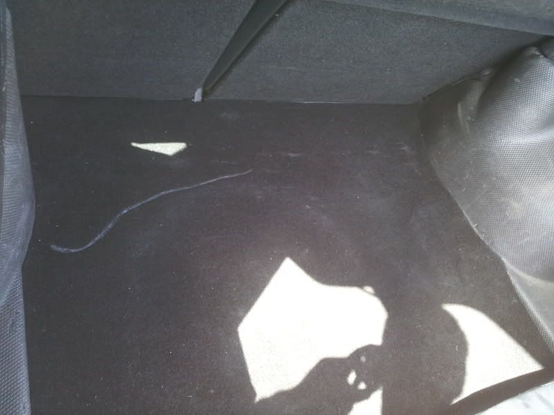

boot carpet (mine has a melted line on it)
scuttle panel (mine was cracked and missing top setction and looks terrible)
door lock parts
tow eye cover
various spare nuts/trim pieces
Best bit was i haggled the guy down to £12 and all parts were like new
I got in and got everything fitted fairly quickly cleaning as i went. I think the boot goes to show how clean this car is!

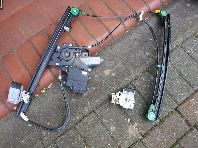

However the work quickly went down hill when i was playing with the passenger electric window. A creak then a crack showed something was clearly wrong and in need of more than a greasing. Getting the door card off to access the window was ok but finding the regulator clips ruined and needing replacement was a bit annoying and took a while to wiggle out leaving the window taped up with duck tape.
The offending item
I could have gone back to the  breakers but decided to buy new and save another one going anytime soon. Managed to get a new regulator off of ebay in the end for about £32 posted. Whilst i was on ebay i also purchased the gear shift repair kit £24, god knows how it all goes together as the haynes confused me with its terrible photos so il take it piece by peice when i get the new one.

Last week i got the window sorted which was quite an easy job and i now have a working window which is nice.
