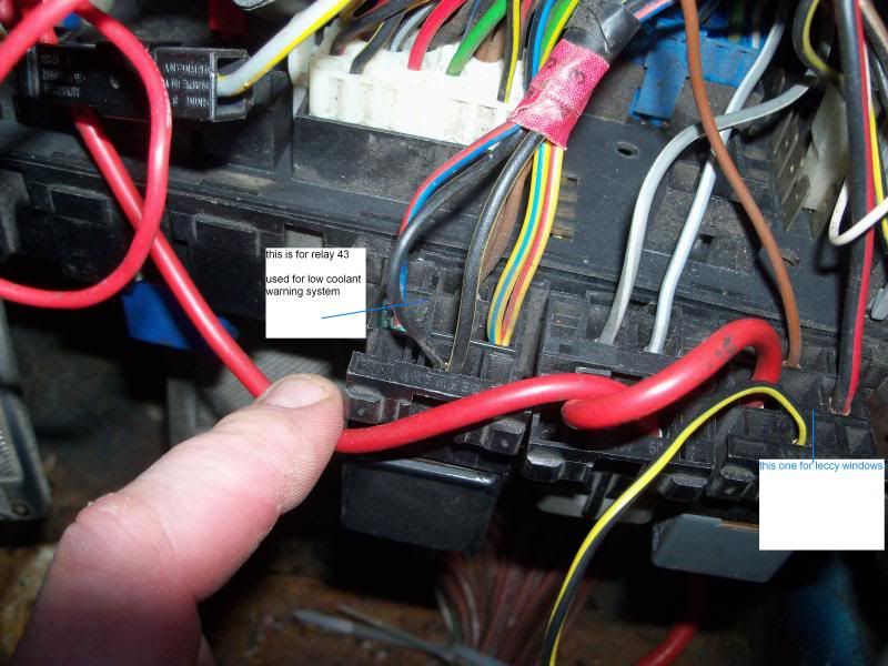

worked out how to do it on here incase anyone else should need it

Bang on again - i had snagged the headlight 2 pin yeallow wire when putting the fuse box back, still got the drivers windows to sort now, switch lights up but no movement in window, looks like its had a new motor also, is there an easy way or tacing the wires for teh drivers window.....ie from switch to relay, relay to window etc????
