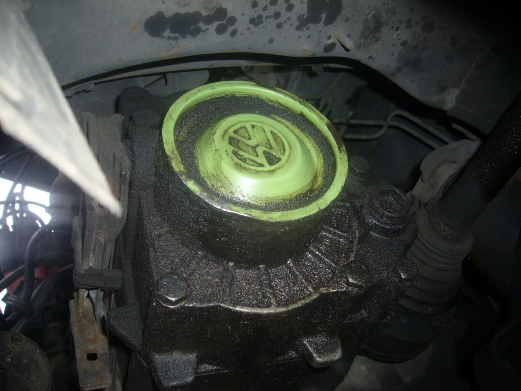

Hi all - Just picked up a 8 valver which I'll be using for the Sucata run in August and noticed that the gearbox is leaking fluid from this green disc.
Are these replaceable? If so, is it a dealer only part?

Yes its replaceable, jack the car up as high as you can on the passengers side so gearbox oil wont spill everywhere and tap it off.
Only about £6 from the dealers.

Easy fix
