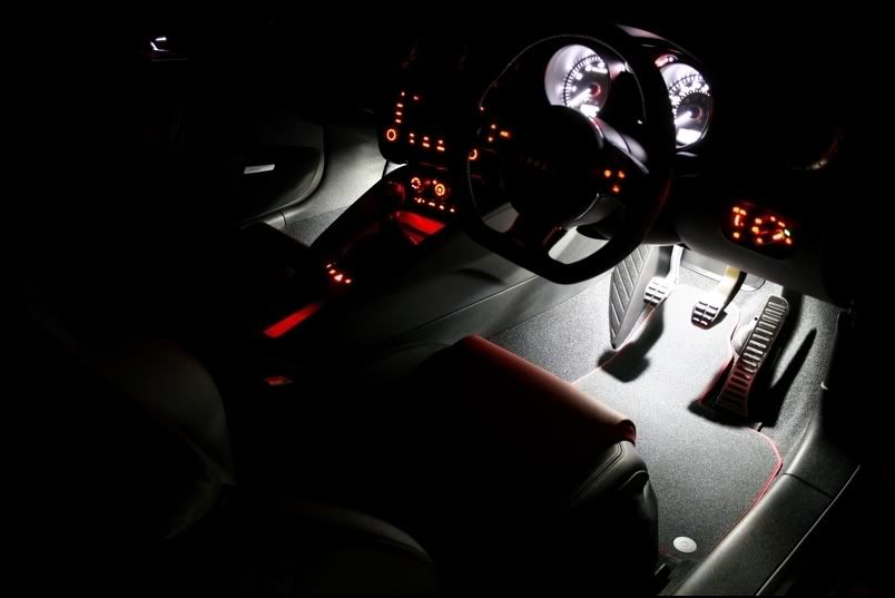

You'll want to head over to the Audi forums (with their existing Ambient Interior LED Light packs)
Retro-fit
http://www.tt-forum.co.uk/forum/viewtopic.php?f=19&t=145743
Part-numbers
http://www.tt-forum.co.uk/forum/viewtopic.php?f=19&t=130383&p=1357194
Personally, why stop there, go all the way with a R8 boot light
http://forums.tdiclub.com/showthread.php?t=285460
Being sensible, I'm still trying to determine if you can simply get the lights and replace the current units. I can't find any concrete information, from
reading the German forums, the Passat LED ones work (no CANBUS warning) but are too long. The Audi ones look the correct size, but...
