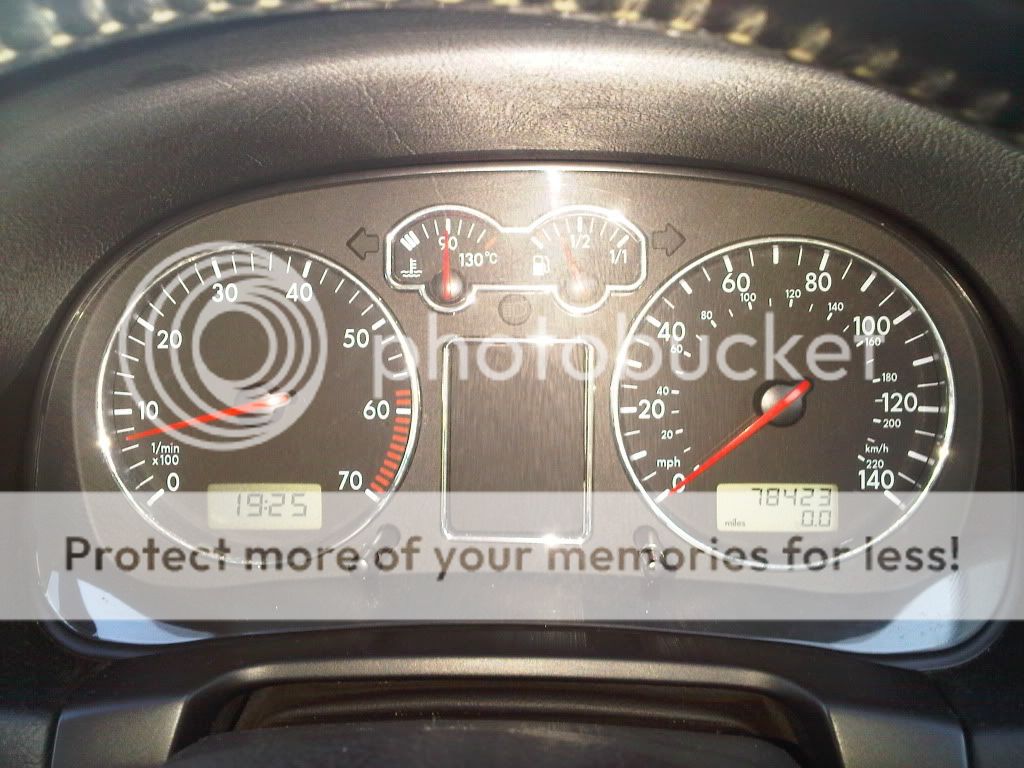

To remove clocks u pull back the leather bit above wheel and there should be a couple of torx to remove and then the clocks pull towards u, theres 1 or 2 clips behind clocks as its plugged in obviously so u need to undo them. think thats it. had mines out a while back now so think thats it.
