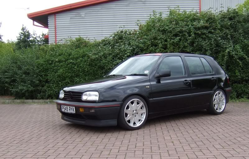

Redders how low are you running yours?
Wayne
Sir Postalot
Posts: 32,051
Re: will 8.5 wide porsche wheels fit?
Reply #11 on:
23 January 2011, 10:16 »
This was 7x17 (et35) with 205/40/17's running 70mm drop on the front and about 60mm on the back, rear arches were trimmed back but would still catch with weight in the back, I never touched the fronts.
