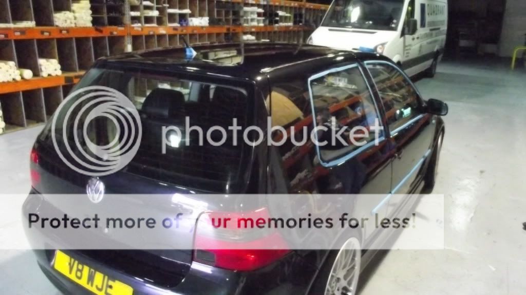

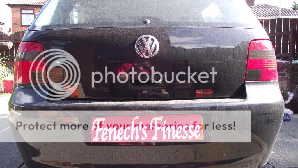

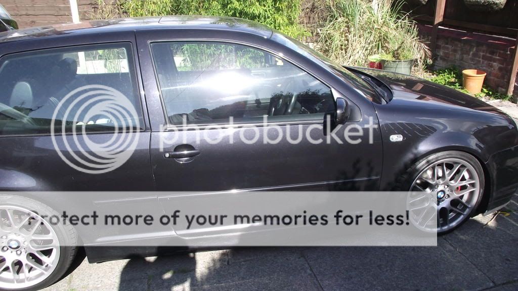

Here’s what the car looked like on arrival :

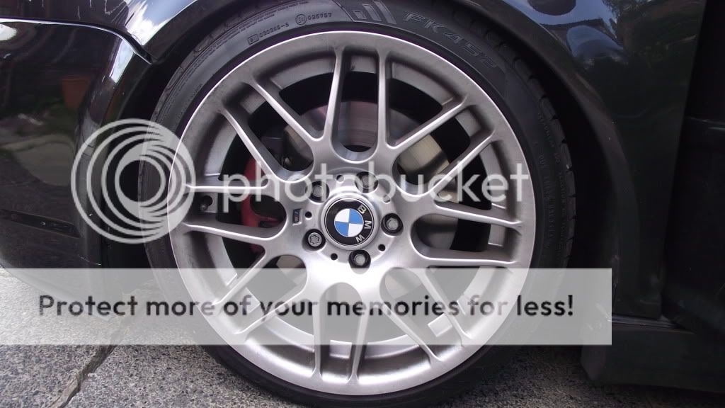

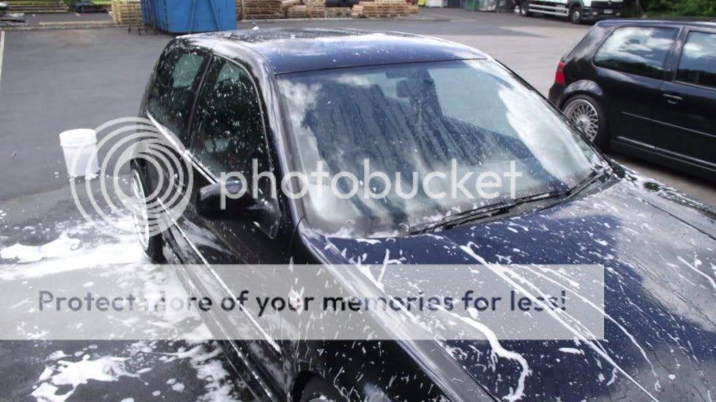

Generally the car wasn’t too dirty, firstly we began by cleaning the wheels , there isn’t any pics of this stage as the wheels are to be removed later on in the detail, after the wheels were  cleaned  the bodywork was then washed :

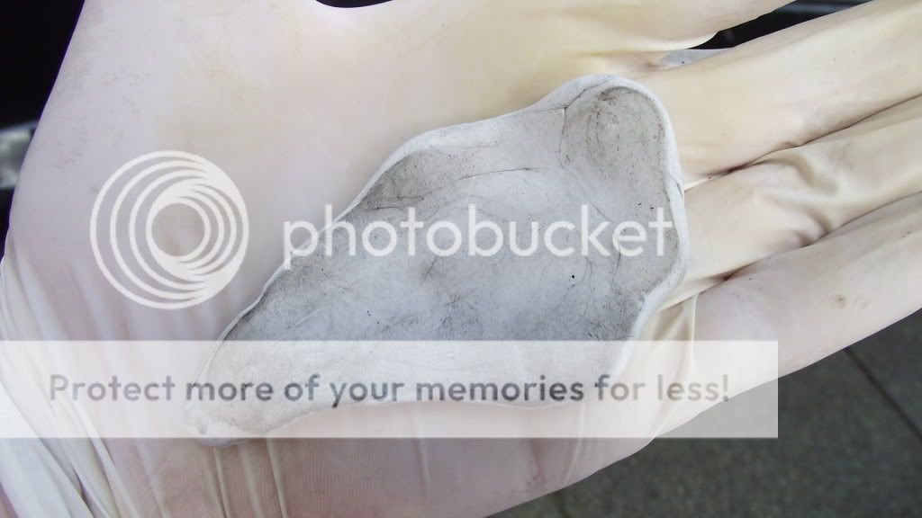

And then clayed , the car was in fairly good condition this being the worst the clay got after the whole of the car had been de-tarred and clayed :

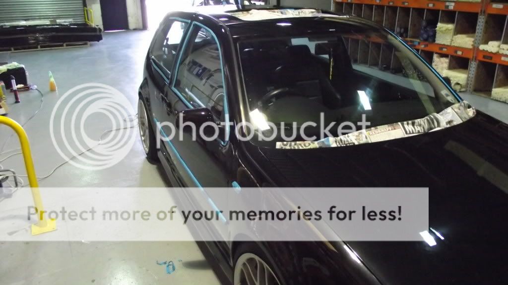

All exterior trim and plastics were then taped up to prevent staining by the polish :

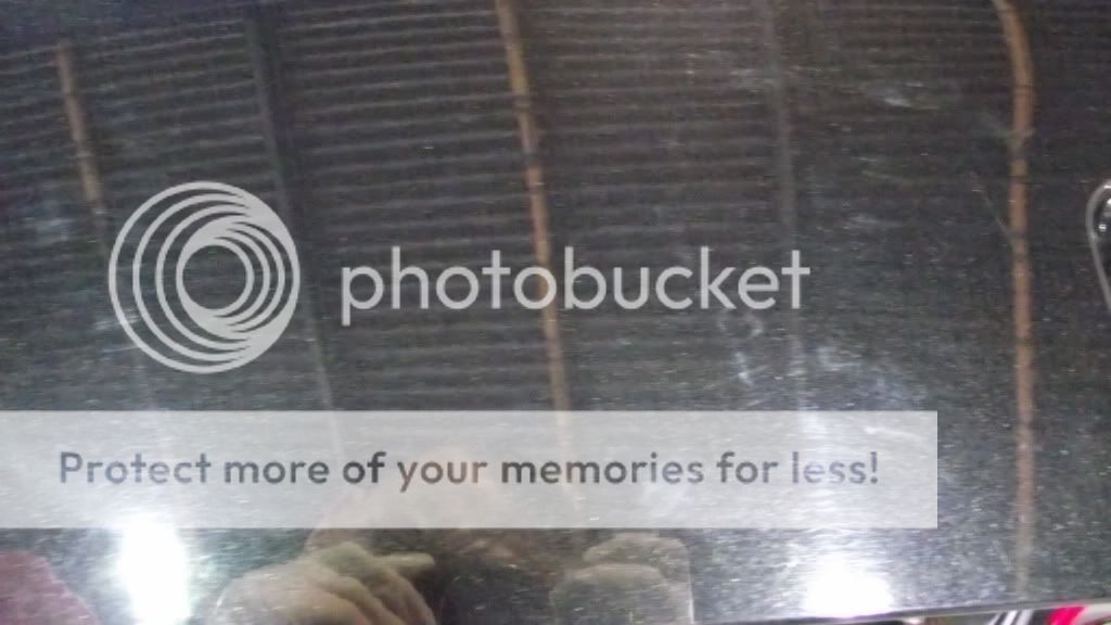

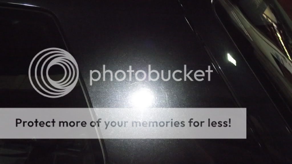

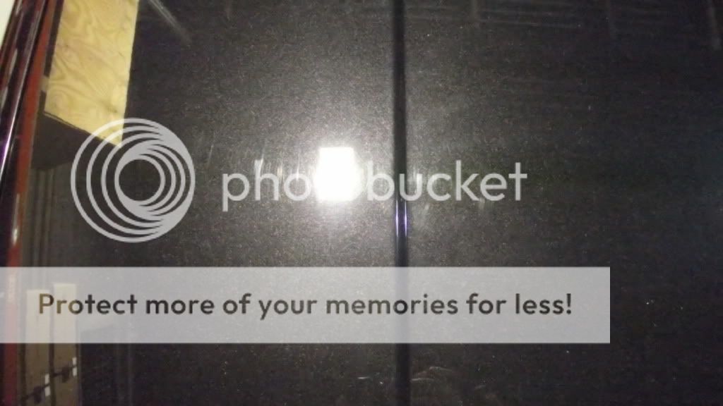

After various testing (we spent approximately an hour trying to find the correct combination) we settled on megs #4 on a sonus SFX1 pad , this being typical VAG paint it was rock hard each area requiring 2-3 hits before I was satisfied with the correction ,the paintwork was then refined with 3M Ultrafina  i love this polish for black cars it really does make it look like a mirror. Here’s some before shots of the paintwork :

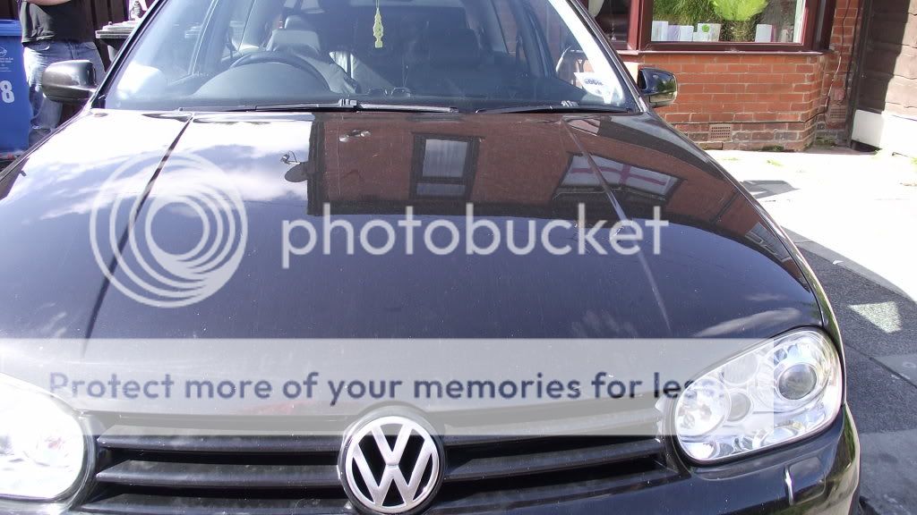

Time was now pushing on  it was 1:30 ish by the time we had begun polishing the bonnet , it was stop and start for me as I  was getting some uncertain looks from Adam whilst he was using his rotary , we started on the outside of the bonnet (left and right side) and then worked towards the centre , whilst Adam did the first set on the centre of the bonnet  I completed the driver’s side wheel arch , after the bonnet and arch had been refined the car was then moved outside in the direct sun we were greeted with these beautiful results (no lsp has been applied at this stage):
