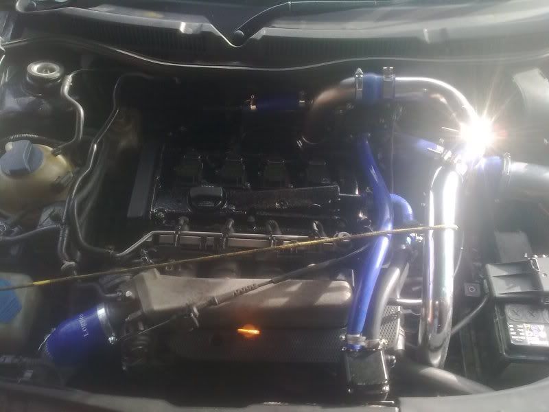

Mine:
I need to fabricate a bracket for top hose though, currently strap held so no movement incase.

« Reply #27 on: 13 February 2010, 01:29 »
god that pipe in the engine bay looks cack!

« Reply #29 on: 13 February 2010, 11:18 »
Haha they do and they are.
And fitment: i run an r32 front bumper and it fits on fine but i set the IC as far back as possible and its 78mm thick. Map sensor, you need a tapped pipe for it.
