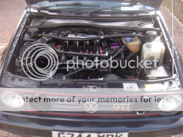

Depends on what fuel injection is on there. K-Jet or Digifant? Picture of the engine bay would help.

Still running on k-jet. Best picture i can do at the moment...

1.8 16v ones are probably what you want, it depends which fuel lines you used! 9a ones have a different thread, though the injector is otherwise the same.
looking at your pics I think you have the 9a lines on there!  best bet is to whip an injector out and let us know the part number.
Its probably a good idea to take all 4 out and make sure all of them are the same, could be you have a mix n match of fuel lines/injectors!  You'll want to replace the injectors as a set anyway, so its something you would have had to do eventually.
