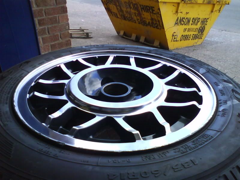

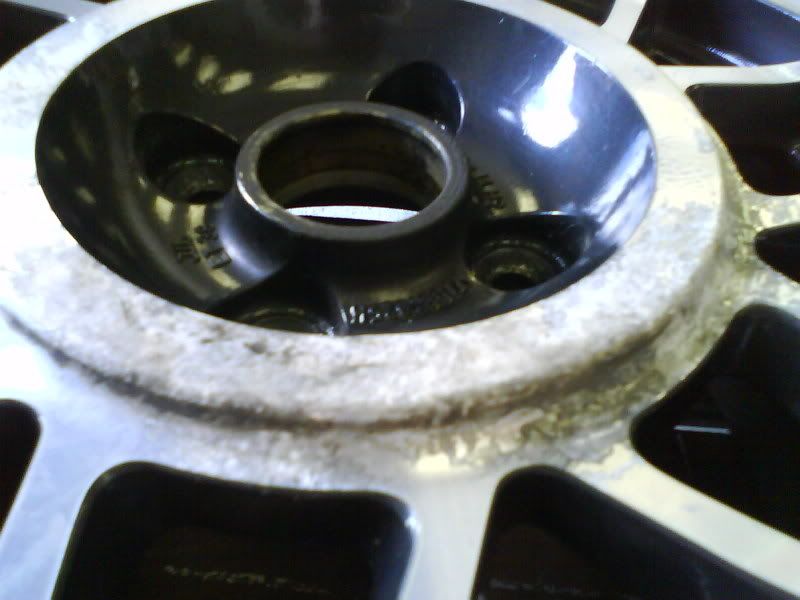

How fast were you using the drill, i have got these fairly polished but its making the mop black, and the bar black.
and i cant seem to get it to shine like a mirror. I sanded them smooth to 1200grit before i started to buff it.
I have been polishing the wheel for maybe 3 hours. Obviously doing something wrong or maybe a need a softer compound to finish it off? With a new mop?

Hmm, just kept going really, sounds like you might be being a bit heavy handed with the amount of polish, less is more! ;)
Could always give the guys at the polish shop a bell, friendly lot that pointed me in the right direction. :)

without seeing the wheels and equipment your using in the flesh its difficult to pinpoint the problem,
But at a guess ,
your drill aint powerfull/fast enough (it is a drill after all not a polishing machine!),
you aint using the right mops or compounds in the right order ,
Its the first time you have done it and your expecting a mirror finish  :shocked:
post some pics of where you are and i will help out if i can,
