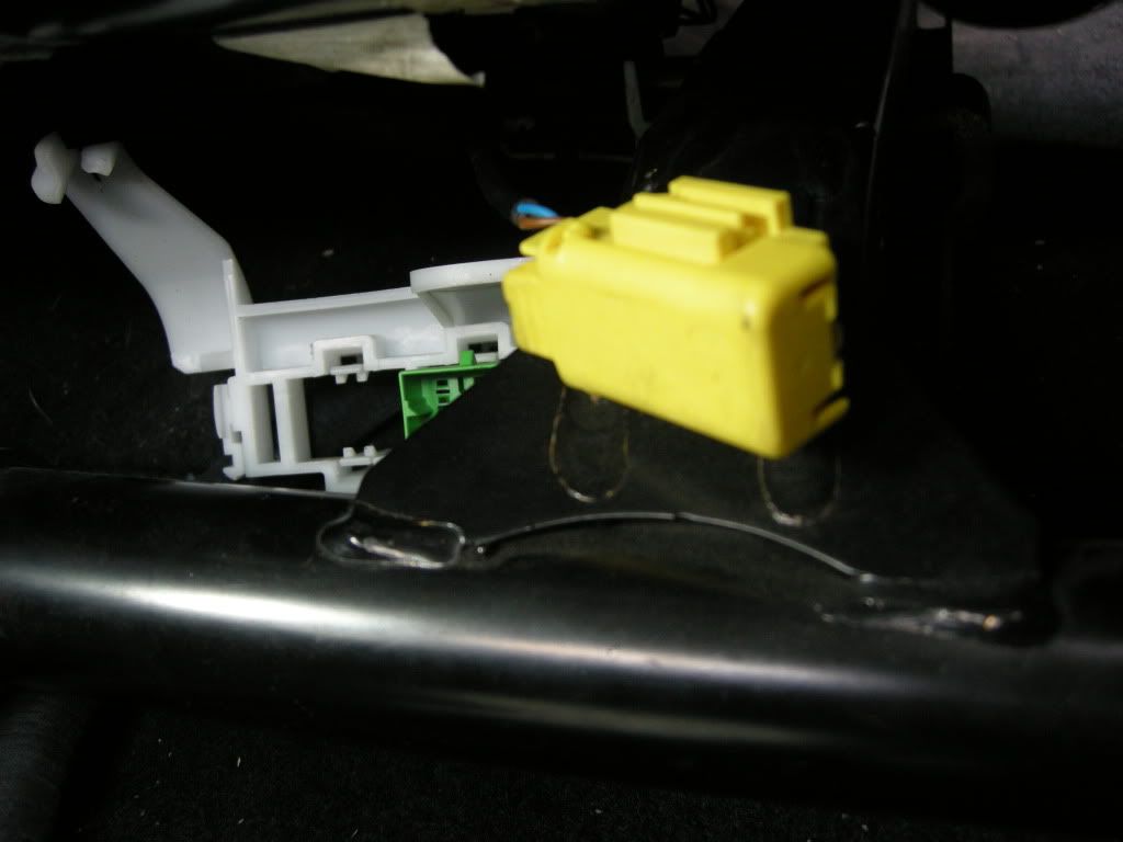

Been looking and cant find a definate answer to my question, the seats are not connected as the connectors are different to the ones in the car and i have now had 3 months of it beeping not active at me  :laugh:. Could someone please tell me the part numbers for the correct clips. I think ots probably best to change the onesin the car not the ones connected to the seats but advice on this would be greatly appreciated
I took pics and the car has a purple connector and the r32 seats have a big yellow connector
Connected to the car loom is this one
This is the one connected to the seat
I think this is the heated seat connector ?

Nightmare mate.
I take it your car is pre 2001? and the seats are from 2002 onwards?
I'd ring VW with the reg of a 2002+ model and ask for the connectors, or chop the ones of the seats and get the seat connectors for your age car?  :undecided:
The green plug is for the heated seats.  :cool:

OK wazzer the part number on the seats plugs are 6X0972783, gonna change the ones connected to the car rather than cut them off the seats
cheers
