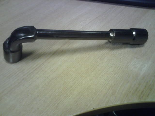

I have been given a tool for the job, Made In France.
Should be much easier now!

Used the tool this morning! It was a piece of pis5 fitting them. May need to invest in one! :cool:
