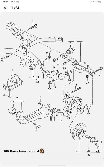

Does anyone know which bushes or pins it’s referring to? I’m assuming it’s the rear suspension or is it the rear of the front wishbones? I’d like to inspect it my self but I’m unsure where to look with the info I have.

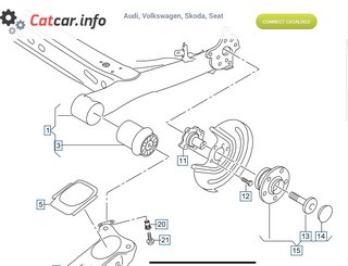

I would imagine it’s the rubber bush on each side of the rear suspension where the rear hub is mounted, number 3 in the pic below

Sorry JB, but that diagram is for a Golf with a rear beam axle, a GTI has independent rear suspension.
I would take a look at bushes 17 and 14 for starters.
