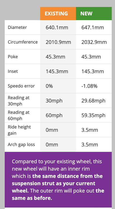

Looking to put new tyres on my 2016 GTD to replace the Pirelli 225/35 R19.  The pirelli’s have been great for wear (over 20k on the front) and handling, but like most summer tyres, not good in snowy conditions.   So i was looking to replace with all season tyres, Michelin Crossclimates, or Goodyear vector 4 seasons or Continental all season.  I am having a really hard job trying to find a 225/35 R19 replacement.   Plenty of 18 inch 225/40.  I notice continental do their all season tyres in 235/35 R19.  I was wondering if here would fit?

235/35R19 will fit they'll just have a bit more protection for the alloy. Most of us run a winter set upon 18 inch alloys for this reason All-Season/Winter tyres are hard to come by and expensive in 19in form, so it's cheaper to get 18's and protects the diamond alloys as well from the salt.

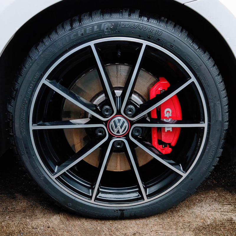

As the OP, Belatedly, I show a follow up.  Went for a set of CM wheels 18 inch Nogaro and fitted them with Cross Climate2 all season tyres.  On my second winter with them, using the 19 inch santiago’s in the summer on Michelin Pilot sport 4s.   The cross climates are superb, the grip in snotty conditions is amazing. I would be happy to use them all year round, but they don’t fill the arches like the 19 inch.    Thanks for the replies.
