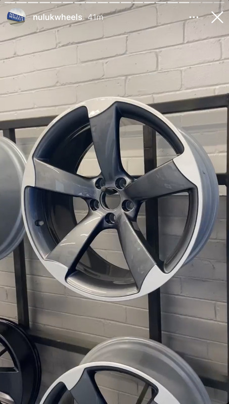

Thought this would help those that want painted alloys but don't want to sacrifice the common two tone look.
My refurbisher I go painted the diamond cut area silver then painted the rest, then added gloss clear coat to the grey and satin clear coat to the silver area.

Those look brilliant! Think the Brescia would suit that sort of look

They definitely would I've started searching for a set now  :rolleyes: The same place also regularly changes the gloss black back on diamond cut alloys to a dark metallic grey to help stop the look of gloss black scratches.
