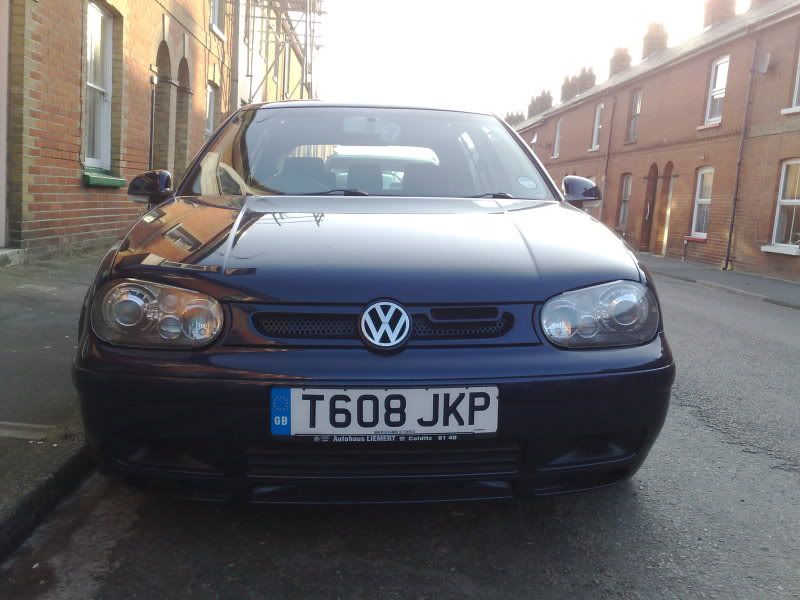

both lights are now finished and fitted to the car and I've got to say I'm really pleased with the result
I'll get some more pics of everything I've done and how she stands art the mo when I wash it 2moro

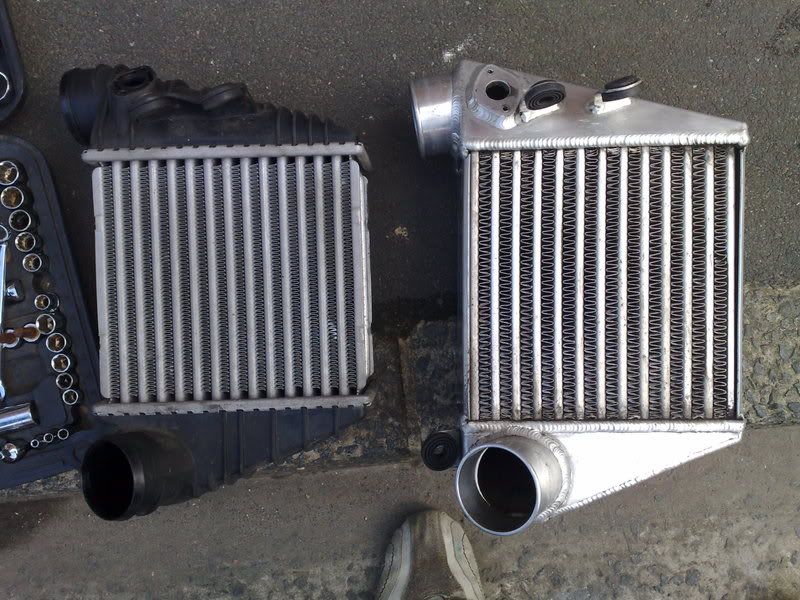

I decided to fit my Forge side mount intercooler today as I had a spare hour. It turned into a 4 hour job though lol
First of all I had to get the standard IC out which was an easy job once the bumper was off
A pic to compare the intercoolers
the gap in the wheel arch waiting for the Forge IC
I had to trim the plastic front panel to allow the end tank to fit
then the new intercooler showing it's face
Only problem is I broke a jubilee clip on the inlet manifold hose so I haven't been able to take it out and see if there has been any noticable difference but I'll give it a go 2moro once I get the new clip on there

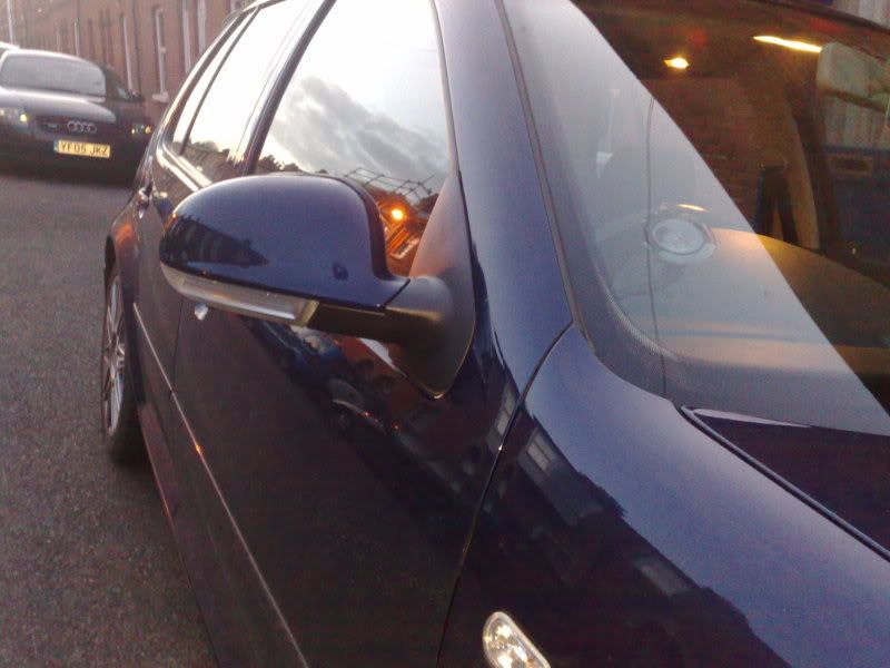

I've finished fitting and wiring in the mk5 mirrors I got a while back. They're not strictly mk5 mirrors but the mk4.5 versions found on the Brazilian Golf
Before...
After...
and the wiring...

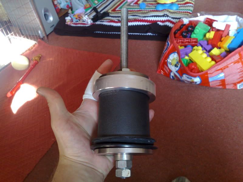

I also had a tool made at work to fit the rear beam bushes, I had to take advantage of working with some very good lathe operators

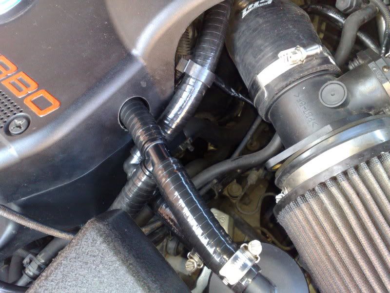

Finished removing my PCV system and fitted my oil catch can yesterday, tried to keep it looking as stock as possible
No more oil vapour being recycled should clean the mixture up a bit
Also gave my throttle housing and butterfly a good clean up as they were caked with oil.
I'll be keeping a record of what I pull out of it

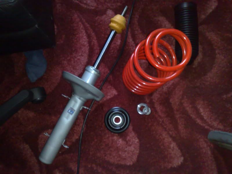

Fitted my new JOM shocks and springs today, only got to do the fronts as I had a bit of a problem getting the old ball joints off as I fitted new wishbones with TT rear bushes as well. I also used new bolts where needed as most of them must be replaced
All new dust boots, bearings, bushes and "sport" bump stops were used
and assembled
No pics of how they look yet as they will need time to settle but I'm already very happy with the feel of them, very good value for money and highly recommended
