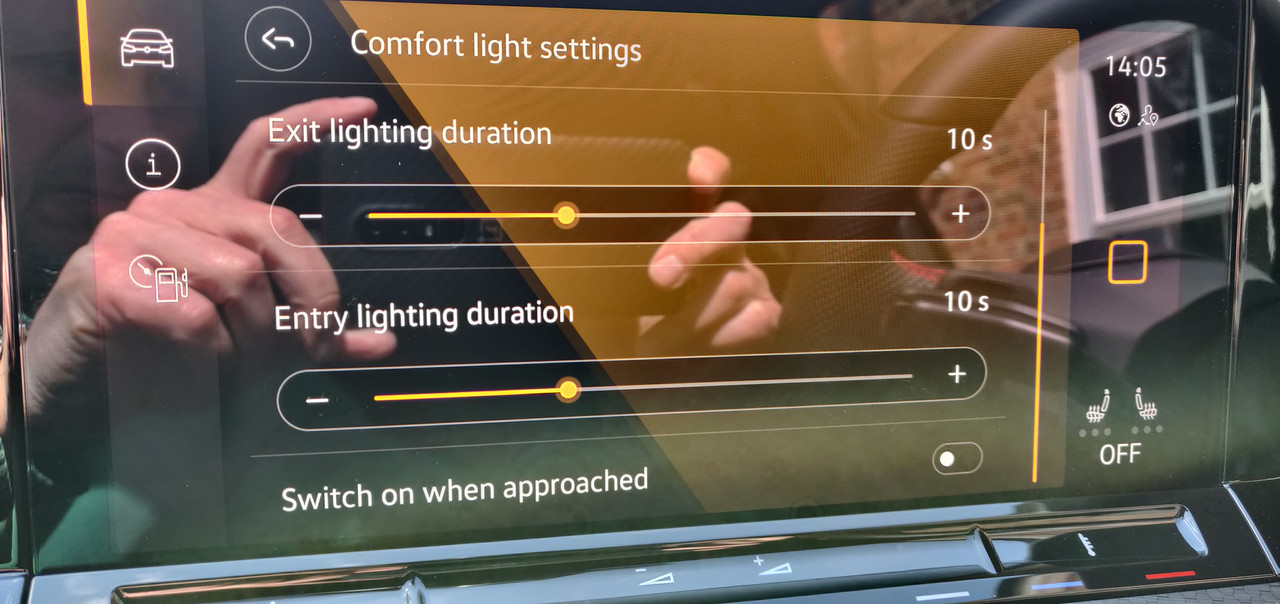

Yes, I have keyless off.
I've worked out why it flashes even with keyless off.
It's to do with the convenience lighting. If you have it set to activate on approach the key light flashes. If you deactivate it, the light does not flash
I have this set to off and the fob continues to flash when within 10m of the car.

I just turned off that setting, blinking lights have stopped! 👍

I definitely don't have that setting... Its a bw48 thing for sure.

I also dont have that setting. Can someone post a photo of this setting?

« Reply #25 on: 07 May 2021, 14:10 »
There you go

Thanks joet. I don't have this option. It must be only for the newer units 816D/820D...
