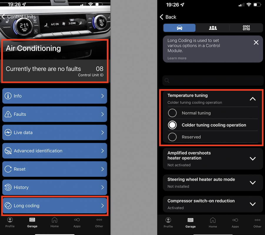

Can any of you kind people with OBDEleven or similar do a coding check please on a Golf 8? :)
I'm looking to confirm whether the Air Conditioning control unit number 08 as installed in Mk8 Golf has the option under long coding to change "temperature tuning" as shown below from "normal tuning" to "colder tuning, cooler operation"
The idea of this coding change is apparently for hot/humid climates, and for the air con pump to be working harder to cool the interior at a quicker rate, possibly with the trade off of fuel efficiency/consumption
It works on my Skoda for example, but looking to confirm it is still changeable on Mk8 Golf

Someone on another forum replied and yes, this selection is still available on Mk8, but now under adaptation rather than long coding
