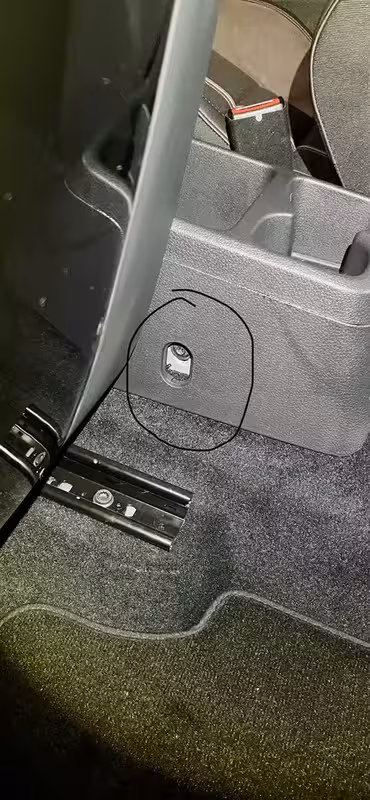

Had my 2017 Clubsport S for a couple of months now and have been annoyed by a revs / road surface related buzz coming from what I thought was the passenger A pillar speaker. But on sitting in the passenger seat it was obviously coming from the passenger side of the centre console. And I finally tracked it down to the plastic cover over the rear fixing of the console - only evident on moving the seat fully forward. The driver's side sits tightly in the hole, but the passenger one was obviously loose on tapping. Removed and car silent now.

A picture of the offending area and solution would definitely be useful if poss? :smiley:

It was the plastic covering that sits in this hole to access the screws holding the rear of the console on. I just removed mine as the seats hide it when pushed back, but you could bed it in a bit of silicone sealant to stop it buzzing (but still be able to remove it if required). Can't believe how much noise it made...
