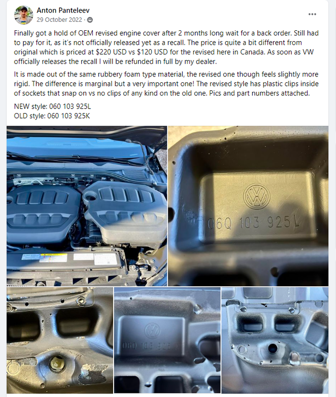

Anyone had a new one delivered with the latest cover they would care to post a pic of?
The new covers look exactly like the old ones, apart from the mounting points being differently designed, instead of the hole the ball sockets push into simply being moulded from the same material as the cover itself, they have a harder white material at these points that don’t soften with engine heat and therefor stay in place, new cars are now being delivered with these covers fitted.
Has anyone had a new car delivered with an engine cover yet?
If so could they let us know the part number of the updated cover so we can check with dealer won't give me any info without a part number or reg  of car with one fitted.

According to a Canadian guy on Facebook, he purchased one:
Useful info that 👍thank you sir!
