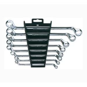

THE EASIEST ways to do this are go and buy yourself a deep socket to fit. Mine are 22mm but I think stock they are 24mm. Try to find one with a flat head, like a spark plug spanner. They are out there, or you could file the sides down like I now have. Or you can use deep swan neck spanners like
 (Thanks Javalin) and one of these:

best way is to get the right sized (24mm??) "deep offset" ring spanner, and a 7mm (?) I think allen key.  If it is the 7mm one, either use one on a socket set, or halford sell a 7mm one with long blue handle for doing vw brake calipers.  Deep spanners - i.e. - http://www.amazon.co.uk/DRAPER-EXPERT-HI-TORQ-SPANNER-DRAP64607/dp/B001FCQVSM
