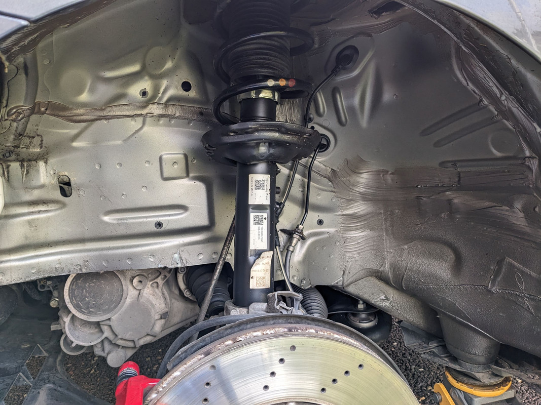

Removed the arch liners from the front, cleaned dried and sprayed with Bilt Hamber Dynax UC. Nothing worthy to note other than dirt build up where the foam block was located.
Foam blocks removed to prevent rust,  they both had dirt and grit on the ends  (the part that sits against the wing) so will likely cause rust long term.

Looks good mate

do these stop wind noise coming through the headlights???

They sit about half way along the arch, kind of in line with the spring. Once the arch liners are removed it's a big area with nothing in it and a lot of metal that might resonate? I think the foam block might just be a baffle to mitigate some noise in the upper portion of the wing from road/tyres, but not sure.  I couldn't detect a difference after removing them. But I've kept them just in case anyone says they are vital for some reason.
