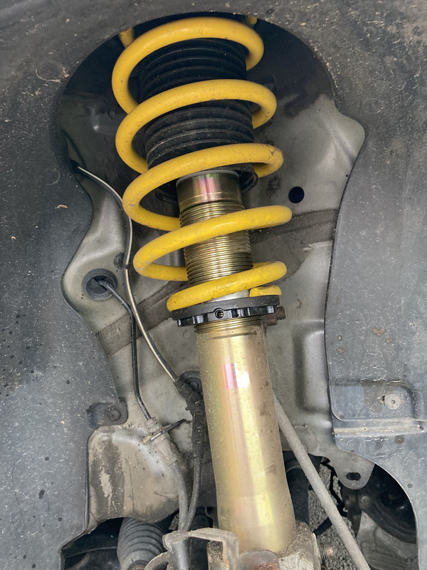

Thought I would do a review to help anyone in future considering suspension options.
I fitted ST X coilovers to my 2019 GTi PP 4 weeks ago now. In terms of fitting it’s pretty straight forward if you buy new top mounts and bearings and just make a full assembly. Saves on dissembling your front OEM suspension to scavenge the mounts from there.
So I did have the usual worry regarding coilovers. Last time I had some on a car was 5 years ago and it was a rough ride. Picked these due to cost / performance. With then being KW Variant 1 internals I thought it would be a good compromise.
Firstly; the ride. Hand on heart it’s honestly barely any different to the stock shocks. Maybe marginally firmer but no harsh at all, ride over bumps, drain covers and the odd pot hole you miss and these soak it up. Very impressed. If you want to keep the golfs comfort level whilst gaining improvement in handling these for me are a great option for the price.
Handling; the car already handles very well but for me it still had a bit of body roll that I wanted to get rid of. These help keep the car much flatter through the corners. Maybe an updated RARB would also help but the car feels much more planted to the road. On rough country roads (plenty of those up here in Northumberland) they are soaking up the punishment very well. The car doesn’t feel jittery or over excited which is something I’ve found cars on lowering springs to do. Just a solid ride that helps maintain confidence through the corners.
Ride Height: mine are wound down quite far with very little thread remaining on the front to lower further, the ride height is definitely not slammed. I don’t think these coilovers are right for anyone wanting to scrape their backside along the road. For me they give a perfect range for a fast road setup / whilst improving visuals.
Hope that helps give anyone a bit of feedback on these. I struggled to find much info to make the right choice.
-Photo taken during height adjusting:
