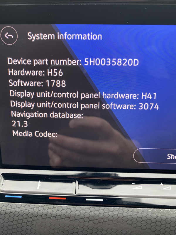

« Reply #7 on: 10 May 2021, 17:36 »
Quick update on this.
Car was booked into the dealers today and they resolved the issue.
Seems a software update was required.
Here’s the system info:

« Reply #8 on: 10 May 2021, 19:42 »
Did they say which software... There are something like twenty plus controllers, all with software and bugs...

« Reply #9 on: 11 May 2021, 07:56 »
No, they didn’t mention the specifics.
There was however a technical bulletin on his screen from HQ regarding this very fault.
So it was reassuring to know I wasn’t alone.
